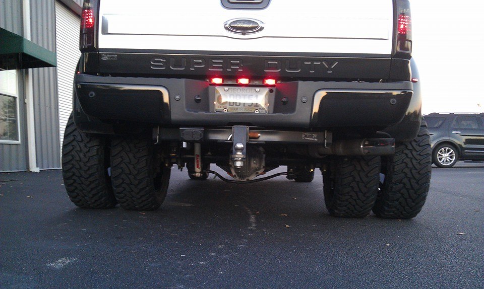

I've just looked through all 56 pages of this thread and did not see a single dually! Any dually owners have a nice wheel/tire package they want to share? I'm due for some new tires and I'm wanting some ideas for my 08.
I have a 2014 F350 DRW. I'm at work now, but will find the pics for you.

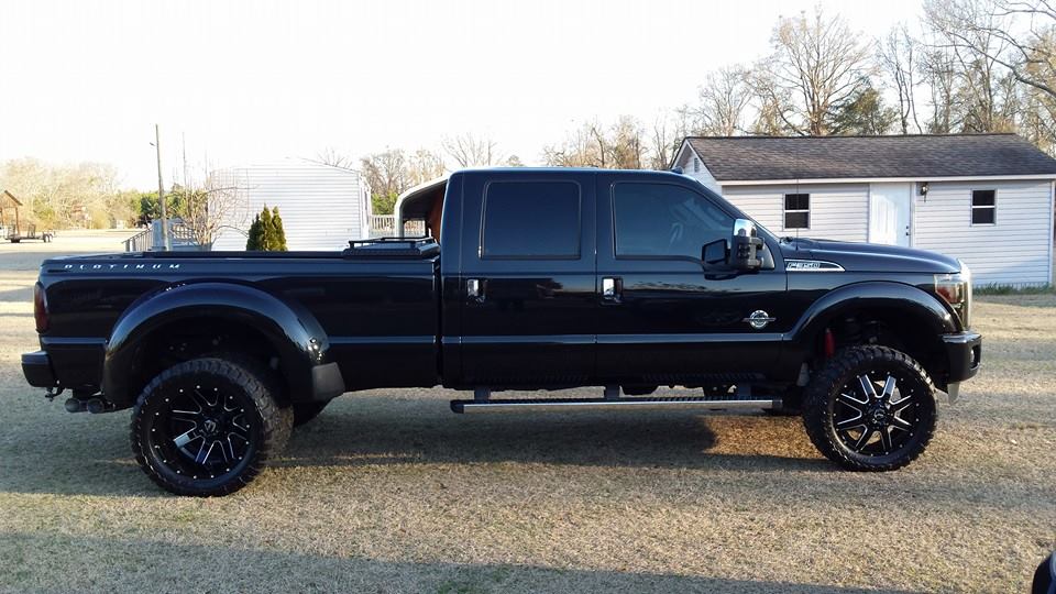

Dually wheels

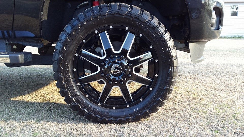

2014 F350 DRW Platinum w/ 3 inch Ready lift. Its sitting on 22" Fuel Dually Mavs, wrapped with 35x12.50 Toyo M/Ts. Each wheel has a different offset (Front +127mm. Rear inner +128mm. Rear outer -215mm). No rubbing anywhere. No cutting needed (unless you put mud flaps on the front).
I'm looking to put 37s on the next go round. :shocked:

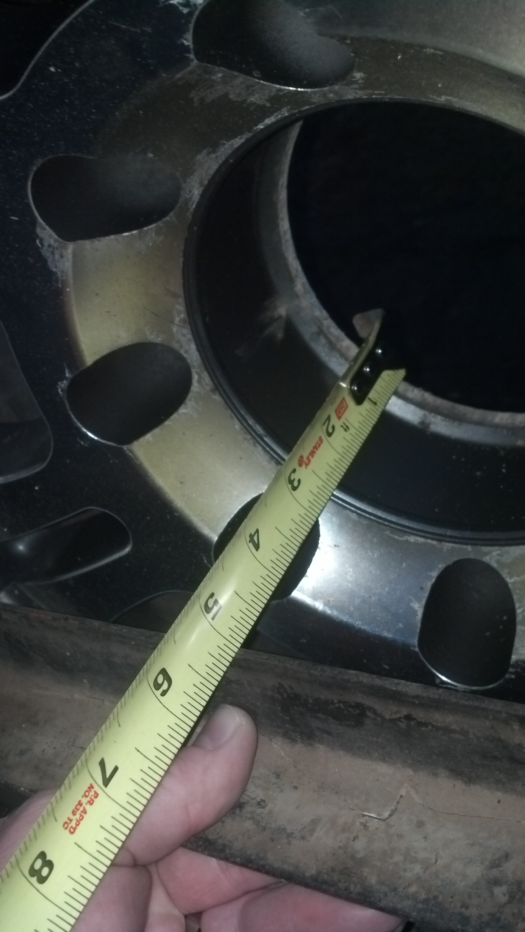

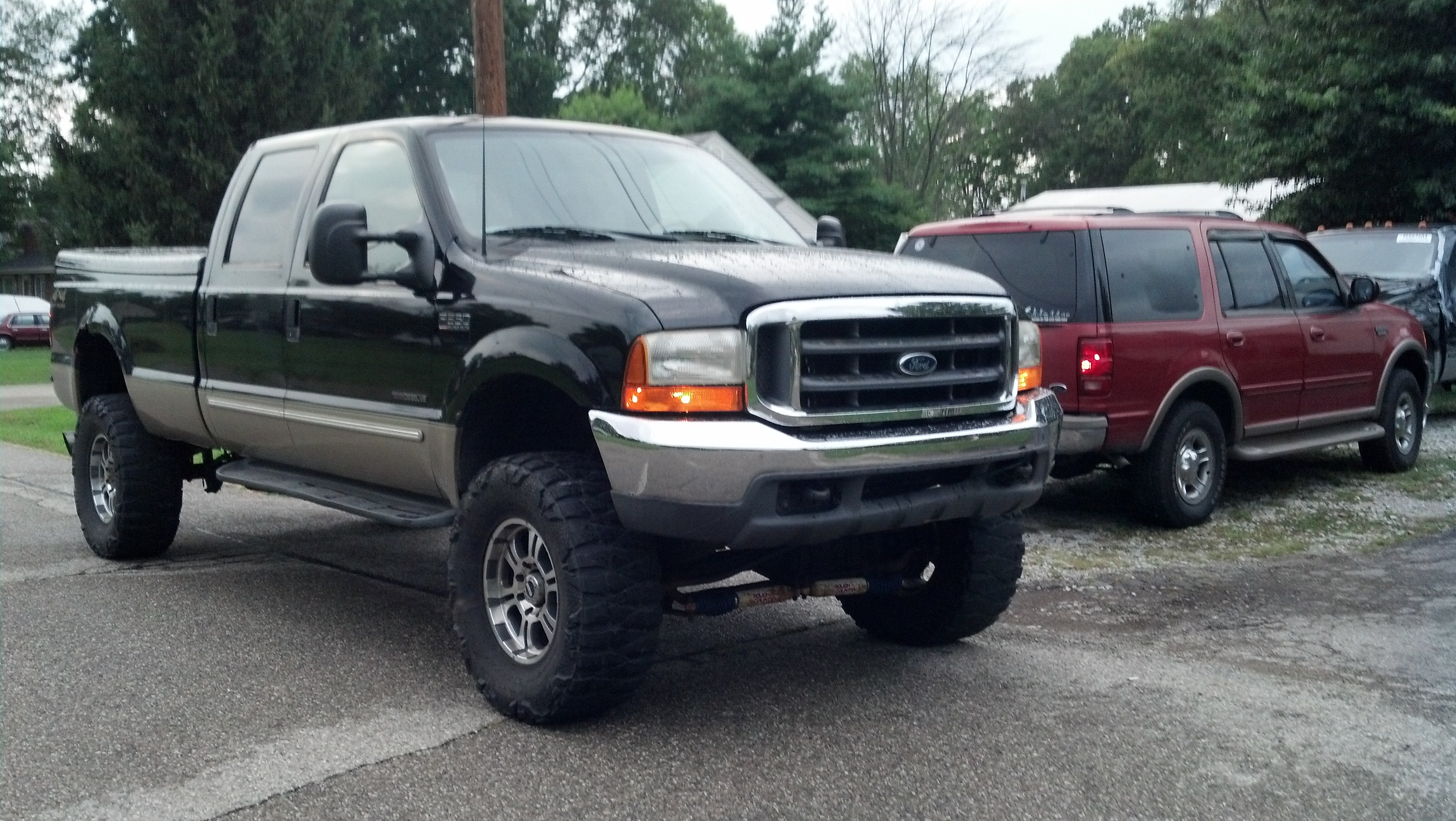

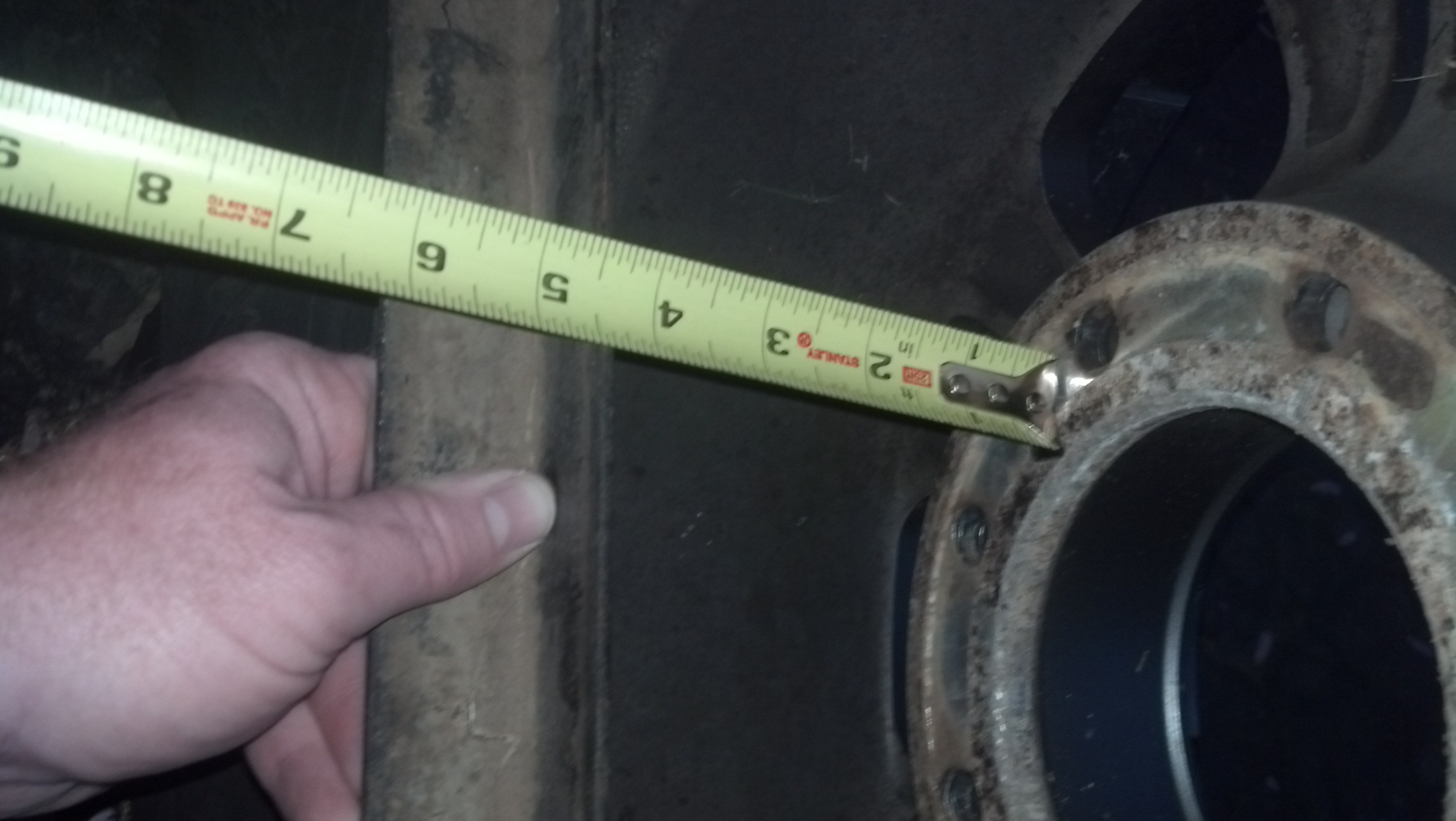

Can someone tell me what wheels are on my truck, the backspacing, and offset? Also, is the offset and backspacing correct for this truck? The truck is a 2000 F-350 CCLB with 6" Rough Country lift. The PO installed the lift new and bought the current tires {37x13.50x18 Nitto Mud Grappler's} and wheels used on Craigslist. I'm wondering if the rims are correct b/c the tires rub the leaf spring at full lock. I thought a 6" lift should clear the 37's, but maybe the wheels are backspaced or offset incorrectly, or it's just the big side cleats on the Grapplers causing it.
The tires will need to be replaced soon and I've always liked the black RockStar's, so if the rims aren't right I might just go with them and either 35x12.50's or the metric equivalent of 36x13 {315-70R18} Toyo Open Country MT's.

A lift will not give you clearance on your leaf springs. Only thing you could change is wheel offset or use a spacer and tire height/width. Or do the 05 axle swap and lose the leafs all together
PwrStrkd73
Jul 24, 2014
3
Thanks, I was just meaning I see a lot of guys running that size. I also put my truck and lift into the tire & wheel package on Rimzone and it came back with the Mud Grapplers in that size as being compatible. I mostly want to know if the wheels are backspaced correctly {i know the '05+ coil-springs trucks have about 2" more backspacing stock, but i think these are close to what I've seen online as the factory backspacing for 99-04's at about 4.5"} and if anyone knows who made the wheels or which model they are.
