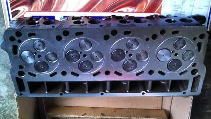

Buy them already done. I bought mine from UCF

Give me a call if you want. I have a shop that does them for a very fair price. What part of NC are you in?
