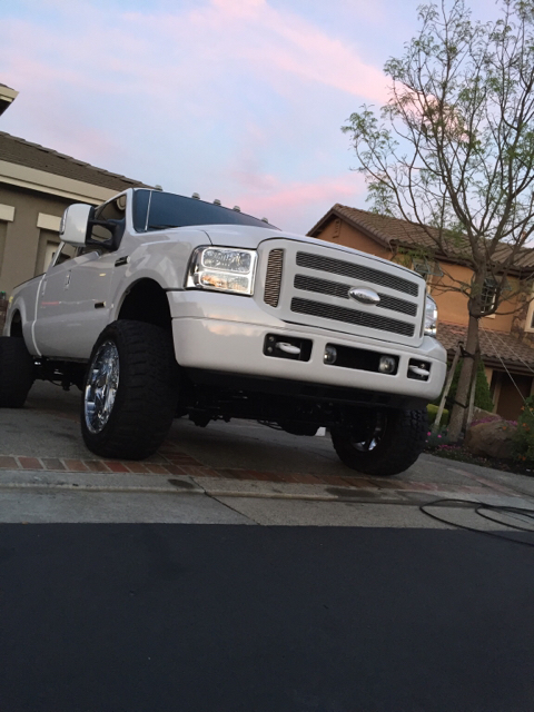

I have 20x12 fuels on 33" federals and I ran fine with no rub with a 4in rancho lift. I now added spacers and needed to trim the bumper and the fender about an inch. First one is without 2" spacers Image1461008102.905553.jpgImage1461008190.651663.jpg
