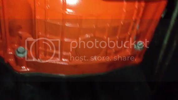

Converter sounds like marbles. Rattling from the bell housing. Pre-filled the converter before install, all TC bolts are in and torqued to spec. Truck doesn't move. 8 miles overall on the new converter and trans. Fluid smells and looks nice. Spun the output shaft and can hear the drums and planetaries moving wonderfully like normal, so I don't believe any shafts inside the trans broke. No codes. No wrench light, nothing.
MorganY
Oct 3, 2011
2,950
college station, tx
Pulled the bell housing inspection cover Dustin and the flex plate is solid all the way up to the crank.
Will check pressures as soon as I get a gauge in my hands.
No load gets put on the motor in D all the way to 1rst gear. Nothing. In reverse there is a split second rpm change.
