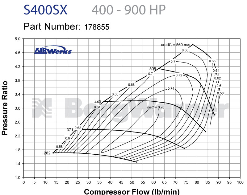

I guess if it was up to me, and it was to be a DD, I am not sure why you would go with a 467 over a 369, especially one with a gated set of pipes. I realized the 467 is a proven setup, but the 369 compressor out flows the 467, should be easier to spool, and with a gate will let you keep hammering on top. Its already proven how well the 74mm turbine side of the s300sxe's are working.
369
467
I look at those maps and see the 467 is a better turbo, look at how fat the center of the efficiency area is.
467 flat out works, and spools low enough to put rods out the block
Did you actually look at them?
The 369 has an additional 77% circle, the 76%, 74%, 72% circles are actually slightly broader on the 369, and after that the 467 starts getting cut off with the surge line. Though very similar, the 369 compressor map is better.
Either way its almost nit picking to decide between the two. But I would still invest in a gated t4 and a 369sxe. But Im pretty ecstatic with how well my 366sxe works. Grossed 23,500 today (scale verified), and maintained 30+ psi up a long 9% grade coming out of Tamaqua at about 2,000 rpm at 1125*. These things flat out work.
I was thinking the same thing you did when I looked at the maps. I'm now map expert though and could be interpreting things incorrectly. I really would like to overlay all the relevant turbo options on one map (same scaled axis) in different colors to see how they all compare.
