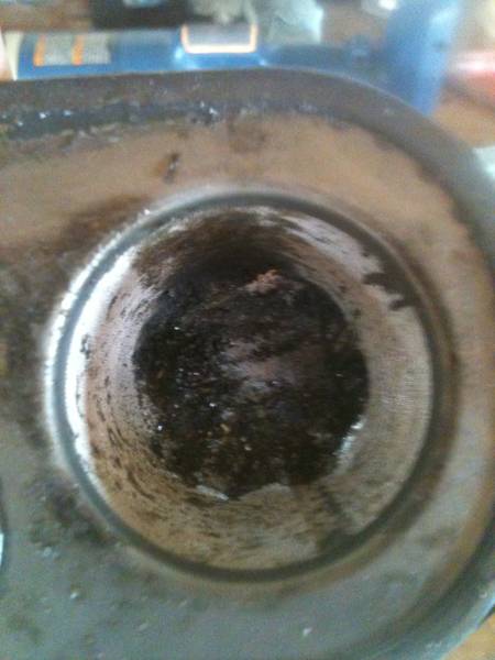

So when I was looking at the spare reservoir, while trying to make my hairbrained idea of stacking reservoirs work, I was looking at the filter screen. There was a significant amount of material in the bottom. It was not magnetic at all, but I could see metal. There was a lot of black fibrous material. The kind that would plug up an IPR quick. Definitely supports getting the Dieselsite adapter for the early trucks that dont have the screen.
Bottom of screen.

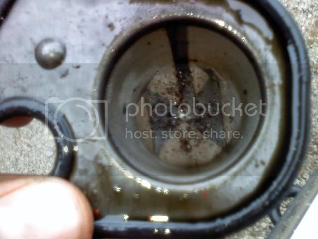

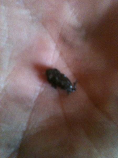

Material I scraped out of the screen with a screwdriver.There was quite a bit embedded in the bottom still, these were the larger particles.

Not having the screen makes it easy to pumpout the rez though....lol.
I plan on adding the adapter one day just dont mix up the orings else bad things happen.
I saw a post somewhere where sombody got the two mixed up......yup cracked the front cover.

That filter is pretty fine and I bet it catches quite a bit of crap if there is any.
