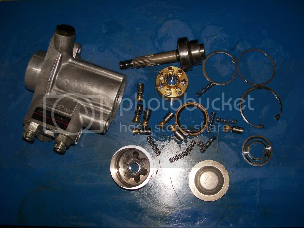

Question... twice in the last two days the truck has died on me... IPR plugged.
Is there any small brass pieces in the HPOP or metal pieces that could cause this?
It could be the motor, but once cleaned and reinstalled it fires right back up...
No screen on this motor, OBS front cover and a SD res...
Not brass but their is bronze piece in the HPOP IIRC. The 17 degree HPOPs use a rear bronze bushing for support and rotation instead of the BB of the earlier pumps. If that bushing is on the way out and is being ground and chewed up maybe that is what you are seeing??

Maybe... happened again last night on the way home. Put my spare in rather then clean the one that was there.
I'm going to order one from Bob and throw the old one out.

I see a few parts that might look similar to brass.

Anybody else got anymore pics of their own crap? LOL
Guess it's something I should to it also. How much is the kit? They were out of stock last I checked.

are you running stealth Hpop?
Bulla had his first one go up on him, brass/bronze was pushing out of the hpop seal into the motor.
There is a video of it on youtube someplace. I'd have to find it.

Nope, I am running a Modded 17* from Joey.
Chvyrkr
2,205
One of the guys on PSO had a modded 17* start poopin brass ish looking pieces, and it left him on the side of the road a few hundred miles later.
He also ignored everyone who told him to swap the pump when it started happening.
Ended up with quite a bit of brass in the pan on the oil change following that event.
