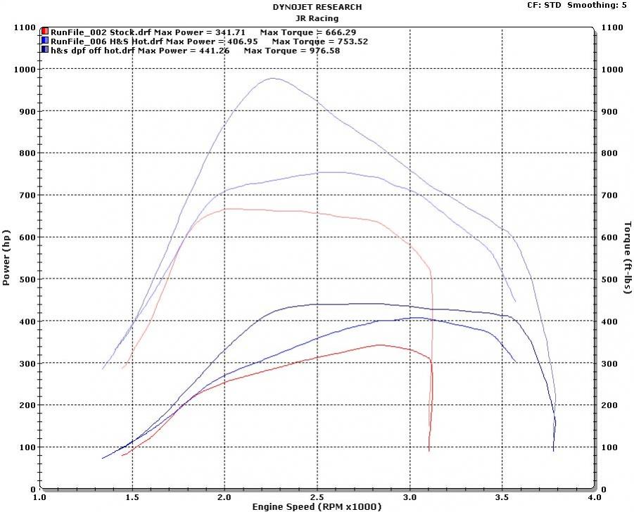

Just for reference, here's mine deleted and on a H&S tune
Stock: 342RWHP / 666TQ
H&S Hot DPF ON: 407RWHP / 754TQ
H&S Hot Deleted: 441RWHP / 977TQ!
Was really hoping to see some improvement over that with the WW...
