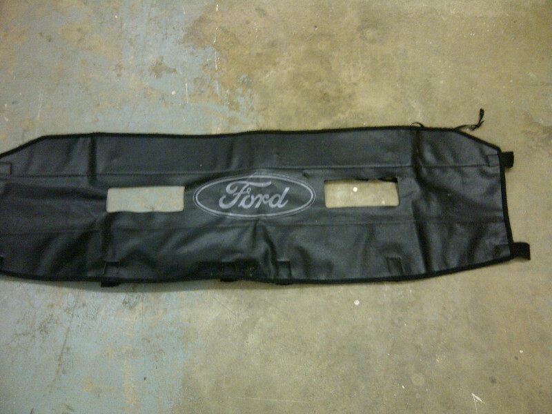

Well for those of us that tow or work in cooler but not bitterly cold climates in the winter. Having to remove and install Ford factory winter front is an absolute pain in the ass when the temp is between -10 and -15deg C. So I cut 2 holes in it to help with some air flow when its warmer but retain most of the wind blocking to help with warm up and prevent boost DTC when its stupid cold out.
The holes are 7.5" X 3.5" and are directly over the center of the IC and rad cores.
