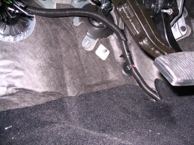

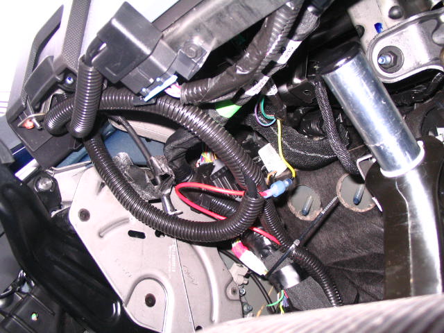

there is not a hole for the clutch any more, stick is not an option anymore .thats where I ran everything in to old truck i ran them through the gromet that the shifrt cable runs theough with slit loom looks factory :)
Cratos
Jun 18, 2012
221
ocala fl, area
here you go
wires run through shift cable grommet
up to upfitter bundle then up to edge on dash for EAS cable
