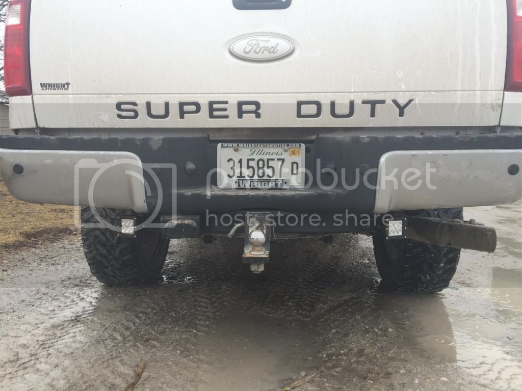

Sorry a little late to the thread here but I mounted a couple of pods on the back of the truck awhile ago. I just drilled a hole thru my hitch tubing and ran the bolt thru it so it is more angled and shines further away from the truck and not straight back. I wired them to my #2 uplifter switch and it works perfectly. The main reason I wired it here is so if I wanted to work behind the truck I can just flip them on without having to have the truck running if j wanted. They also home in extremely handy when we're moving fields at night with the draper head. I can turn them on when I am taking corners with it and it lights up the whole head as I'm turning. Here is a picture of what mine look like mounted up.

Thanks man for the pic and info! I still haven't wired mine up yet but I did end up figuring out a mounting spot and hardware necessary. It'd be nice to have a secondary set of pods I think on the tool box in order to light up the bed and work area behind the truck. Might do that down the road because it seems like equipment always breaks down right before dusk lol
