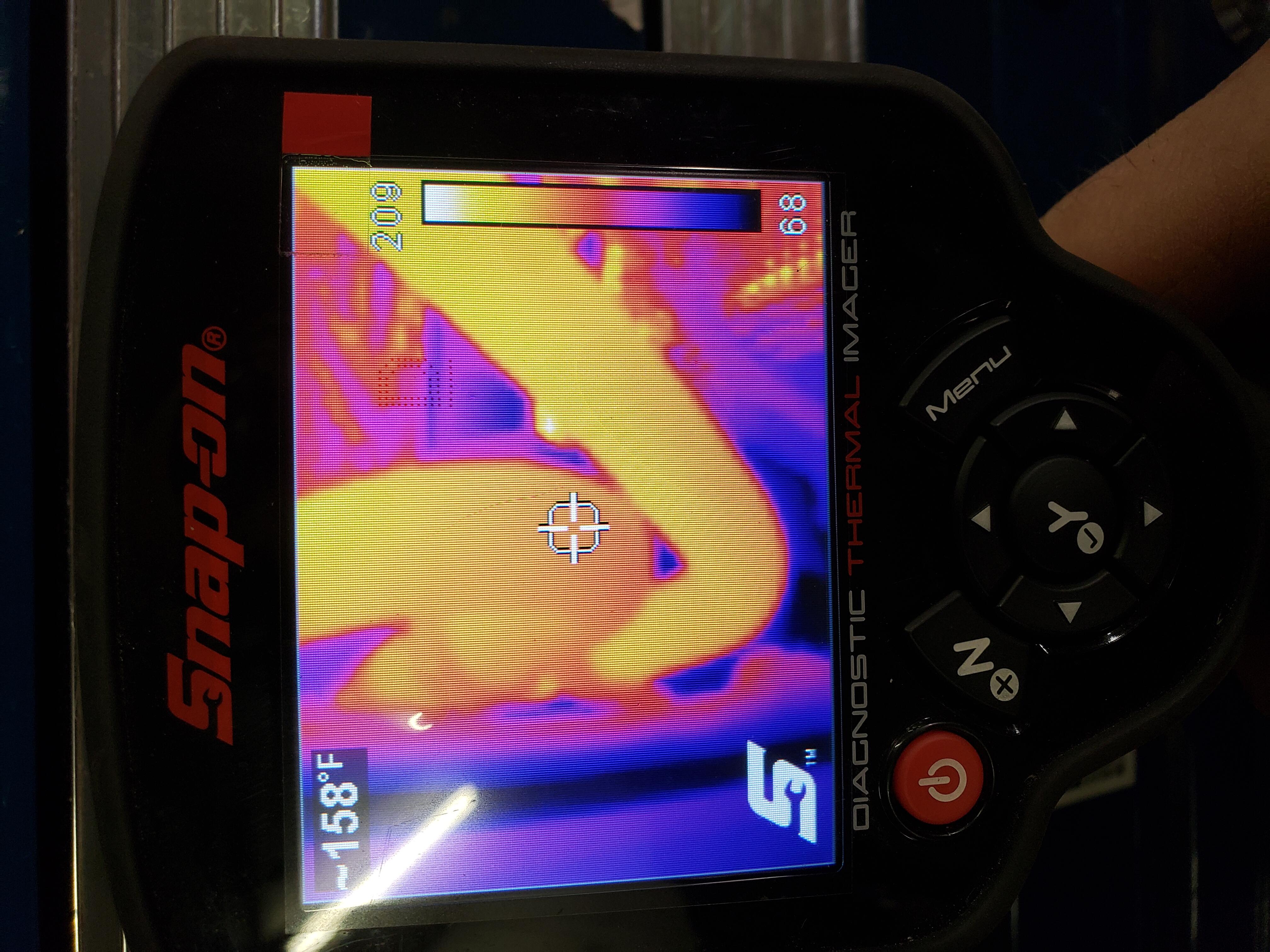

Just pics of my gun on a clogged then fixed heater core flow
