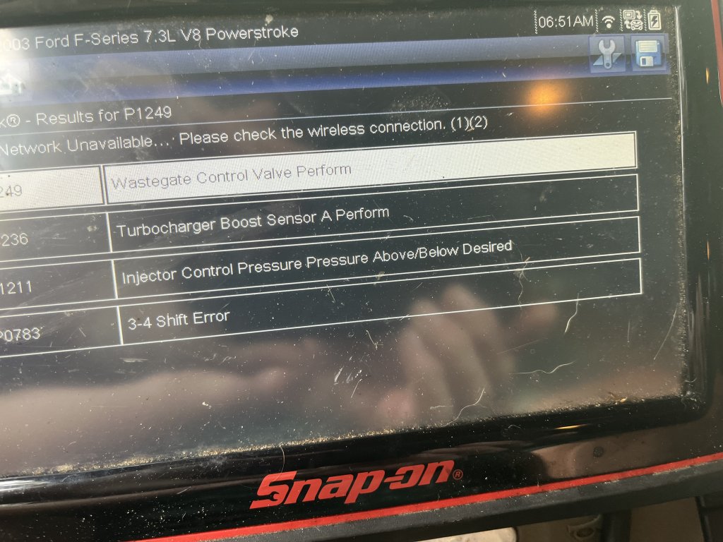

That 1211 code is gonna be your problem. Typically icp sensor or fuel pressure. Check your icp sensor for leaking, and that the pigtail is in good shape. Only replace with motorcraft parts if they need replaced. Key on engine off, icp voltage should be .23v. If it’s not leaking, and over .03v over or under, replace the sensor, and replace the pigtail for shits and grins. Then get a fuel pressure gauge on it and go drive it. Fuel pressure should never drop below 45, and with what you’re describing, it’ll drop to 0 if there’s an issue most likely.
