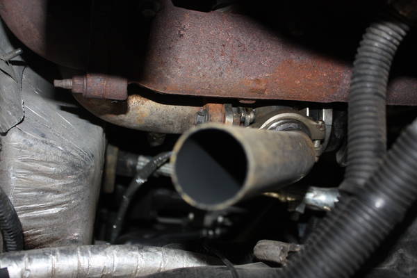

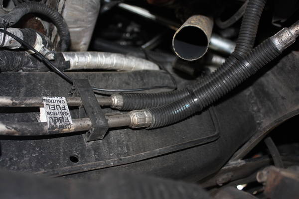

Pictures aren't great, but you get the idea.
From below, looking up, you can see the manifold and the gate right next to it.
Truck has almost 4,000 miles on it since the gate was installed. You can see the soot inside the gate pipe, but the frame and parts near the outlet are still soot free. Doesn't seem to make much of a mess at all.

Thats a damn good idea using the factory egr pipe, ***in genius actually, gets the gate in an easy spot to use it, and as far as soot, the gate doesnt open till things are wound up tight so smoke isnt as heavy and whats comming out of the gate shouldnt have too much smoke, nice work guys... thats ***ing awesome placement for a gate...
