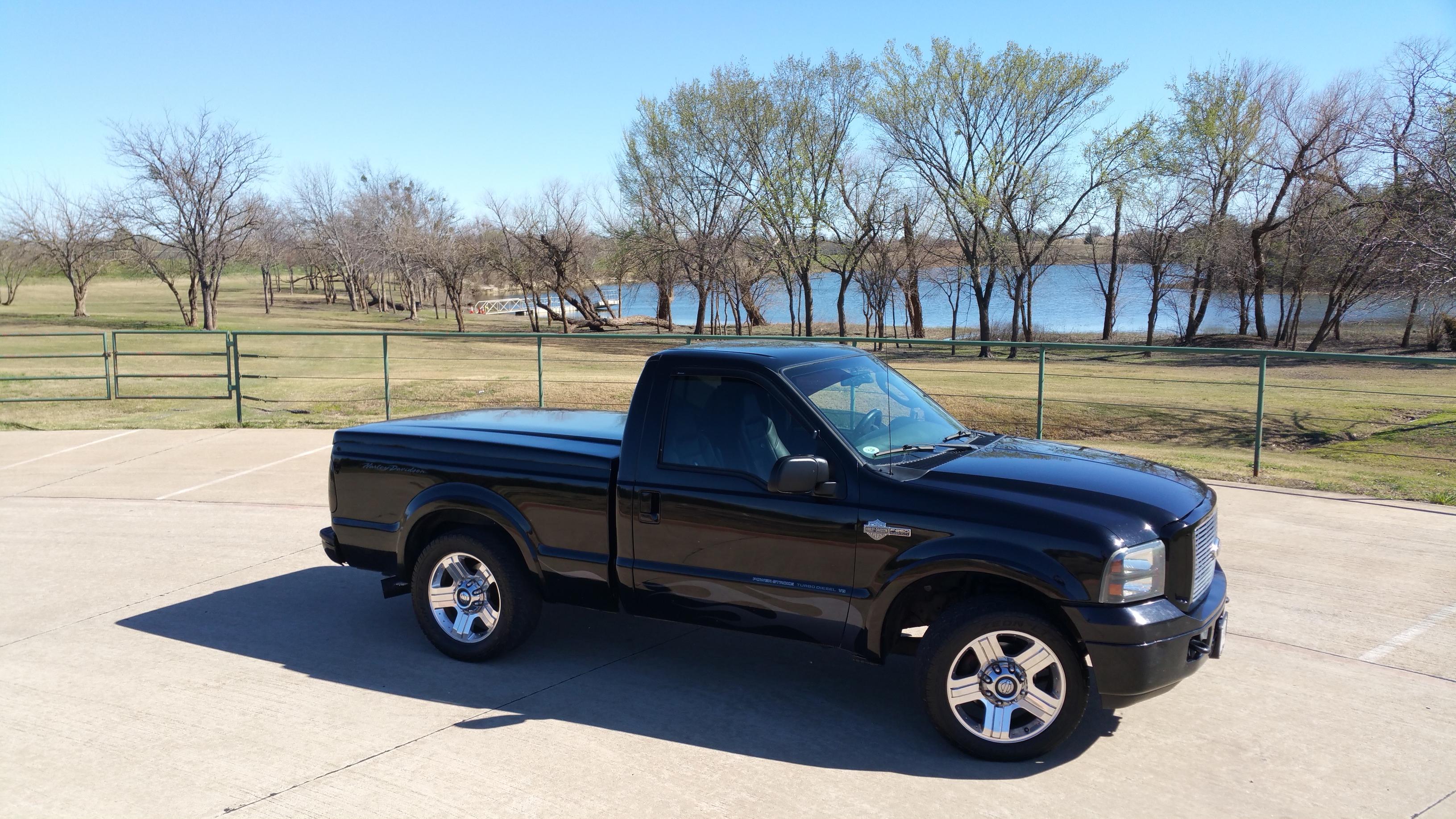

I have the f150 tank
This truck was built with an F-150 tank:ford:
