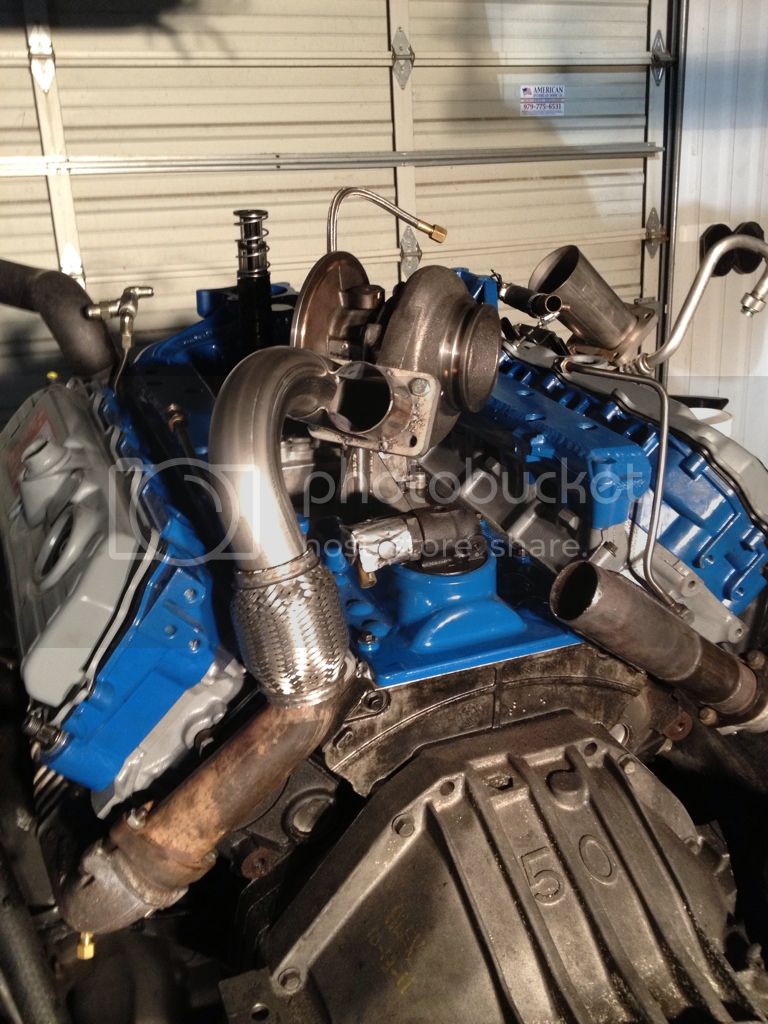

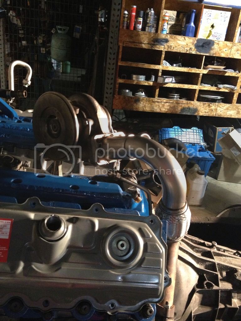

I appreciate it Shawn. I hope to have it at Ennis in April. Doesn't make you look bad at all. UPS took forever to get things straightened out. Couldn't have done this build if you weren't able to fix those sticks, so Im very grateful for that.
More photos to come later today, up pipes were a challenge. Used a 2-1 collector into a T3.
FaSSt9602
Jul 27, 2011
605
Gilbert, AZ
They come together into a single vault housing. Use a 2-1 collector
Yea, a second look at the pictures and I see the open T3...
On that note, has anyone ever tried to take a set of T4 divided pipes and run a BD or ED T4-T3 adapter? I know Shawn tried a set of divided T3 on the tow truck and I am not sure how they turned out, but you would have the benefits of divided pipes in a T3 housing...
