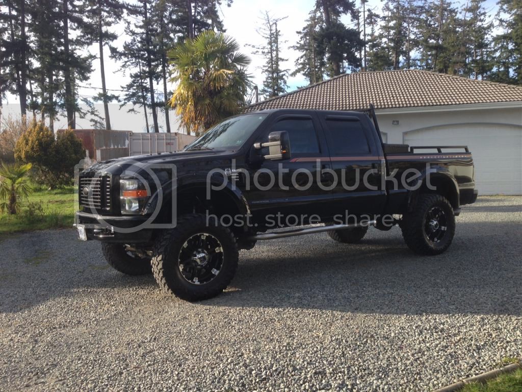

Hey guys, I have been following the forum for a bit now and thought this would be the best place to ask about turbo upgrades. Right now i have the BD - twin turbo upgrades 73mm primary and 58.5 secondary, the highest numbers i have gotten is 602rwhp and 1188 torque. I thought we would be able to push more out of these turbos but i guess not. I was originally hopping for 700 + rwhp, but now if i am upgrading turbos again I would like around 800rwhp.
My truck is my daily driver and I tow up to 16,000lbs about 15% of the time any thoughts would be appreciated.
Here is my truck build so far:
2008 F350 6.4L Harley Davidson Edition - 82,000kms
Exterior:
• 20" KMC Wheels
• 38" x 13.5 Toyo Open County m/t
• Chrome Nerf Bars
• Bushwacker 2" Fender Flares
• Black Headache Rack, Side Tie down Bars and Tool Box
• 6000k HID Head Lights
• Rigid Dually D2 Flood Fog Lights
• Rigid Dually Flood Back Up Lights
• 20” Rigid Light Bar In Front Bumper
Suspension
• 6" Fabtech Lift/ Dirt Logic 2.25 Nitrogen Shocks
• One Up Offroad 7” Traction Blocks and Ladder Bars
• BDS Steering Stabilizer with Fox 2.0 Stabilizer Shocks
Engine:
• H&S Mini Max Tuner - Custom KEM 345 Performance Tune
• AFE 4" Cold Air Intake
• 3" Intercooler High Flow Piping
• BD Diesel Cool-It Intercooler
• Elite Diesel EGR Delete With Waste Gate
• 4 3/4" Turbo Back Dual Exhaust With DPF Delete
• BD 6.0 Exhaust Manifold
• Port & Polished Heads - Port Matched to 6.0 Exhaust Manifolds
• Elite Diesel Ported Intake Manifold
• BD Twin Turbo Upgrade
- 73.0mm Primary – 58.5mm Secondary
• River City Diesel up Pipes
• Fass Titanium 150 GPH Fuel Pump and New Style Suction Tube
• Industrial Injection 85% Dragon Fire High Pressure Fuel Pump
• Elite Stage 1 Ported Fuel Rails
• Elite 110hp 8 Hole Nozzles
• Air Dog Fuel Bowl Delete
• Arp Headstuds
• Powerstroke Elite Oil Cooler System
• Sinister Coolant Filtration System
Transmission
• North American Diesel Performance Race Series 5R110
• Upgraded Billet Torque Converter
• Upgraded Billet Input Shaft
• Upgraded Billet Internal Shaft
• Upgraded Billet Ring Gear
• Upgraded Mag-Hytec Transmission Pan, Holds 22 Quarts total
• BD Diesel 6.4L TapShifter
Interior:
• Custom Stereo: 4 Speakers, 4 tweeters, 10’ Subwoofer, 2 Amps, Kenwood Touch Screen With Wifi, 3 Tv Screens
• Build in Radar detector
• Remote Start + Alarm
