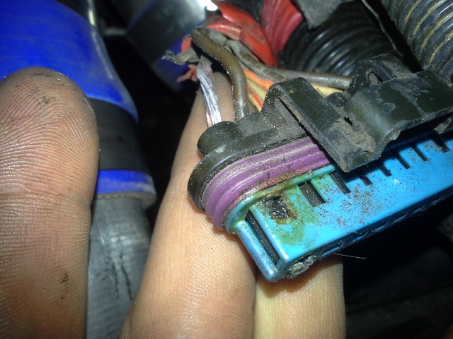

It runs!! Unfortunately I have an issue with a glow plug. Luckily its on the passenger side thats easy to get to. Hoping its just the uvch. I have a whole nother set of glow plugs too View attachment 1

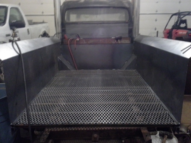

Started on the box. Need to shorten it up a bit though. Itll hold my fourwheeler which is all I hoped for. Still need to get some 5th wheel rails and a new water pump

Not much for progress lately. I shortened the box up a foot. Once the floor of the box is done then its time for finishing the wiring. It still seems to crank pretty long before starting, not sure but im thinking of switching to 5-40. I loved it in my 02 and plan on going back on the next change. only having 4 glow plugs doesnt help either but it should be better than it is for sitting in a 50* shop
