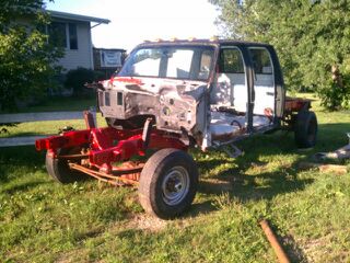

The body will be the original blue metallic that the obs was offered in.
Well, working my way around the cab with a flat head screw driver i found out above the windshield on the passenger side is rotted out so i need to replace that now too. Still not bad for a salt bowl truck all its life. That little spot and the driver side rocker is all that needs replacing on the cab

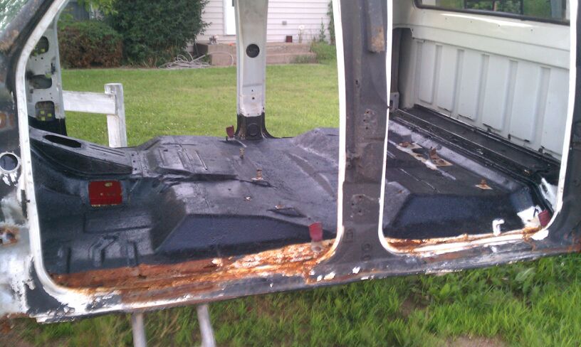

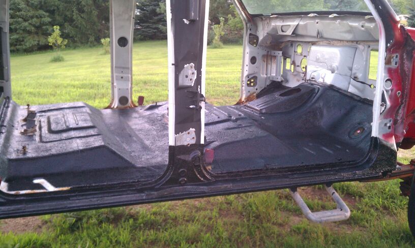

Most of the cab floor herculined!

Another

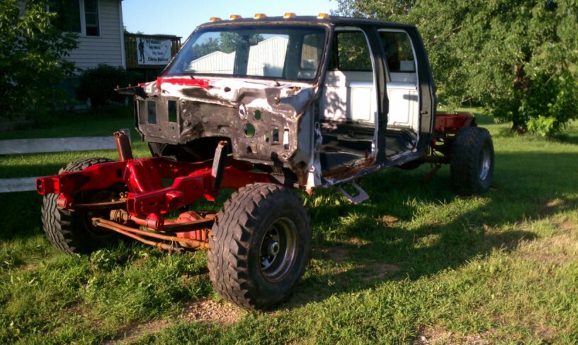

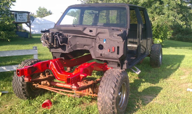

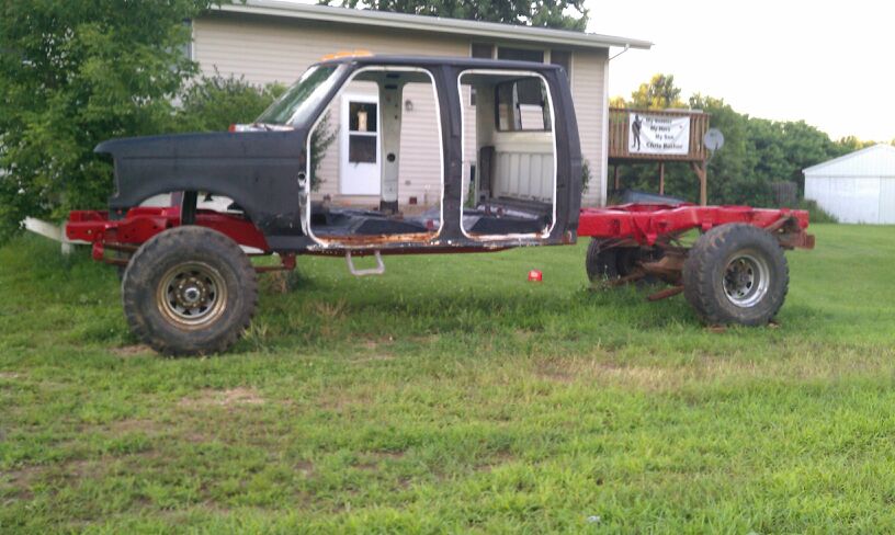

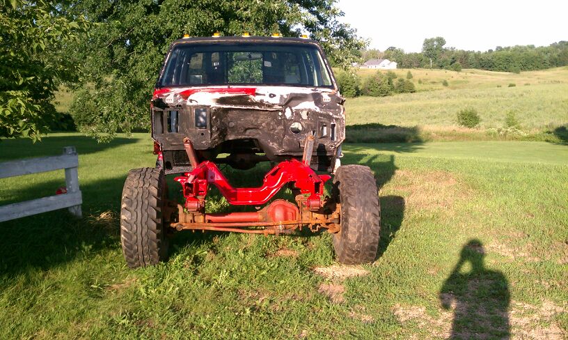

heres with 36 inch humvee tires on 16.5x12s and with a fender for mock up. Them 36s look small. Yes its stock height

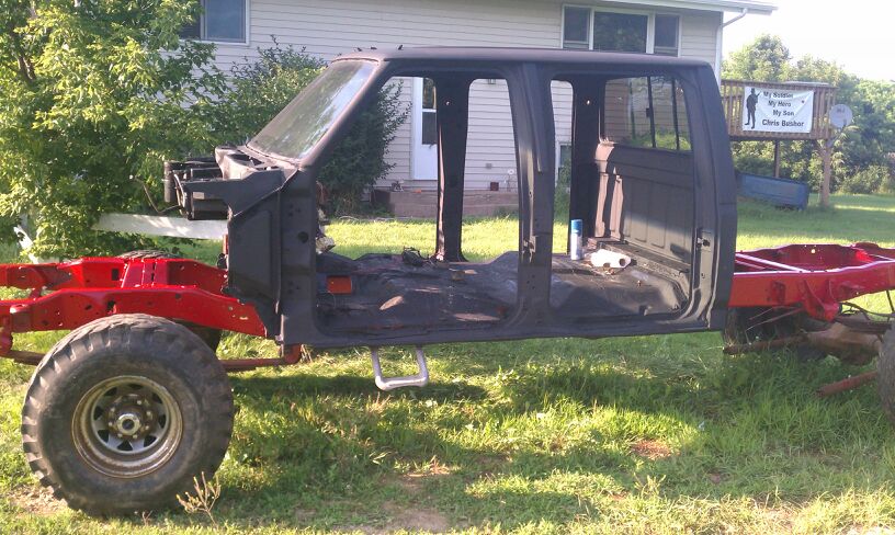

The cab painted and starting to go back together... But my dumba55 cant find half the bolts and screws!

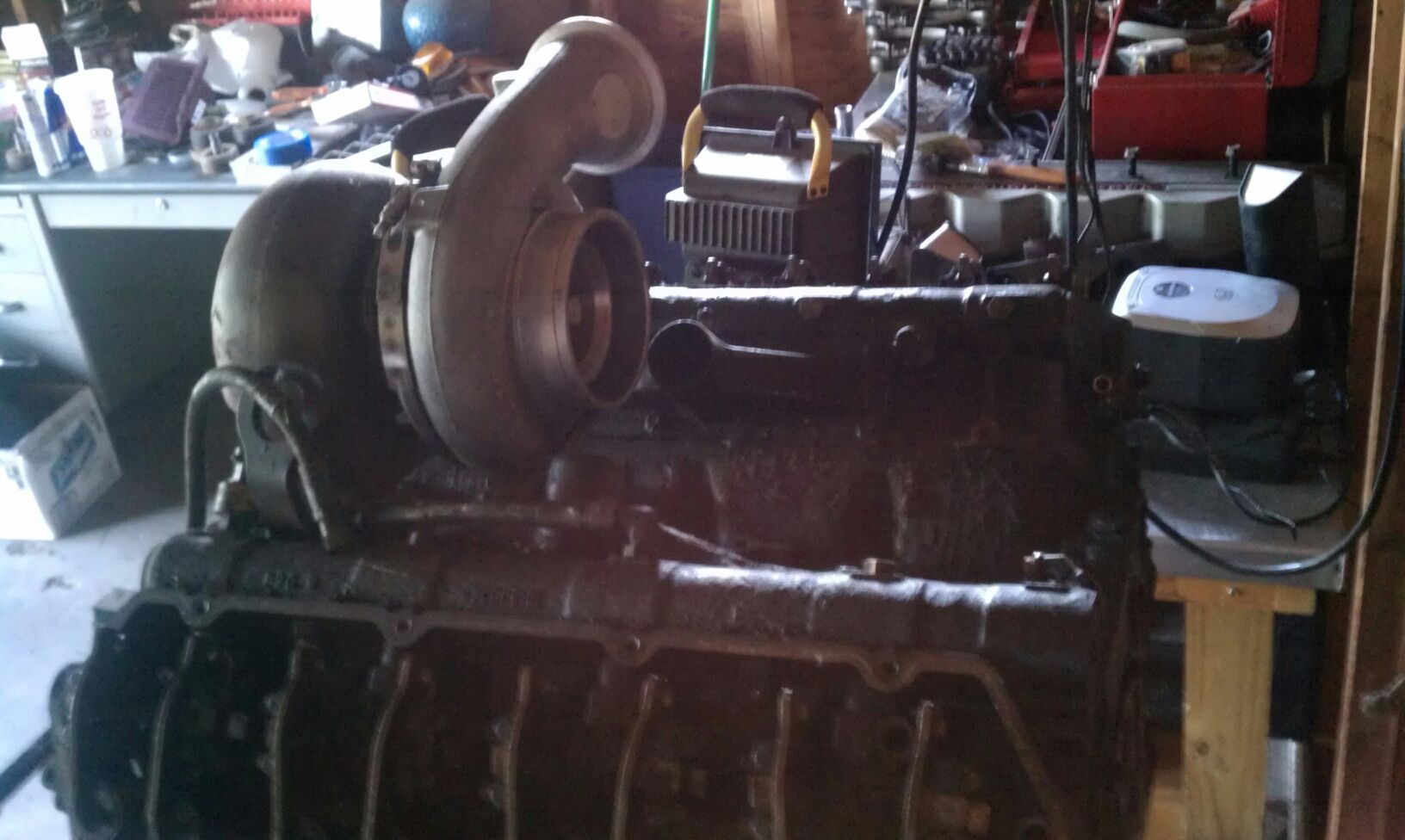

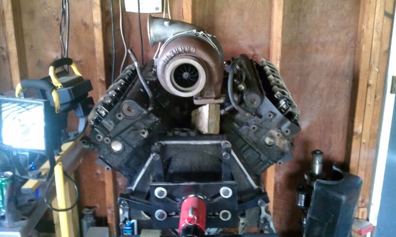

Mockin up a gta4202
Sent from my EVO using Tapatalk! Snoothie Bootchies

No... For the supercrew you are thinking about the 01 and newer crew cab half tons. Super duties are reg cab, extended cab and crew cab
Powerstroke Cowboy
May 20, 2011
4,539
228
Montana
Form the Pictures, It looks like you will have clearance issues were the turbo is sitting. The Turbo air intake and Plenum's look like they are in the place..
Maybe I cant see right on the pictures... But that is what it looks like.
DcMoore
722
Amarillo, Tx
Maybe I missed it but I thought you were putting a Cummins in it... And how the heck are you going to make the DP with out it being crushed?
swamp_ratt
1,506
hudson, wi
I have to modify the firewall and floor pan to get the allison in any way so ill cover the downpipe then too
