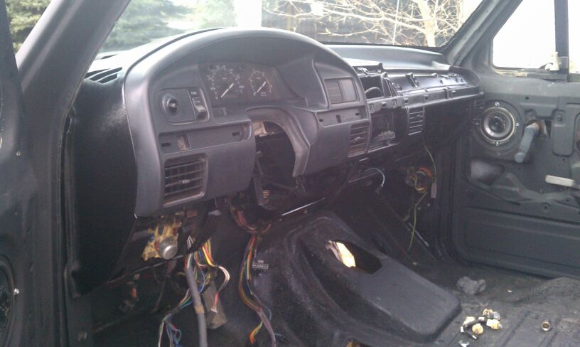

Slow but certain progress. Pickin up the cummins soon then getting it bored and giving it some coated marine pistons! The head will be o-ringed as well and ported. Not right away, but down the road when its ready for go fast mods. Sourcing a transmission. Looking at the possibility of an eaton 10spd, but we'll see where the road takes me. Went to put the steering column in and found somehow one of the mounting tabs was broke off so need a new column!

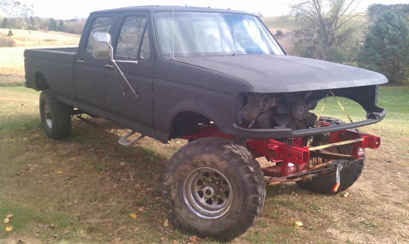

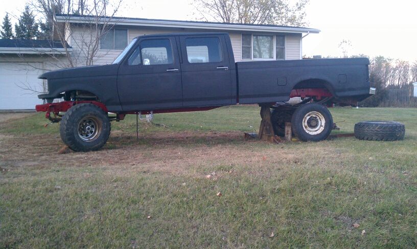

well, hit some snags... Ordered in the axle plates to put the u-bolts the gm way with the nuts under the axle and them are for 2.5 inch springs... Got the old axle out and rolled the new axle under and my buddy and i were only about 4 inches off on spring perch width. Have to cut the perches off and narrow em. Dammit! So plasma cutting and welding is in store for this weekend! On a positive note, the cummins will be here soon and in for machine then rsk, then engine rebuild kit with goodies! Heres a pic of tonights work. More to come tomorrow in better light! Bye bye drum brakes!

As you can tell... I REALLY need to invest in a jack and jackstands haha!

The truck is outside. If this project would have taken a few weeks i would have had it in our shop but no can do when im doing it at this pace

heres some more. Axle will be done this weekend! As you can see the axle is not centered. I did this to set in the blocks to measure u-bolt length
