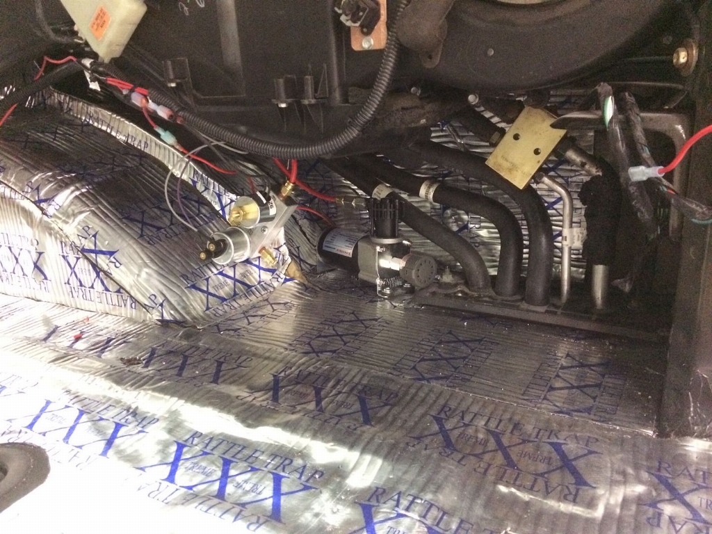

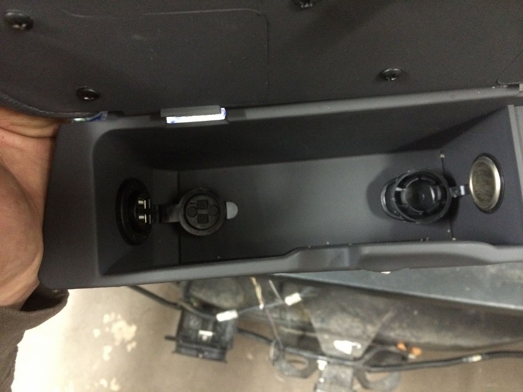

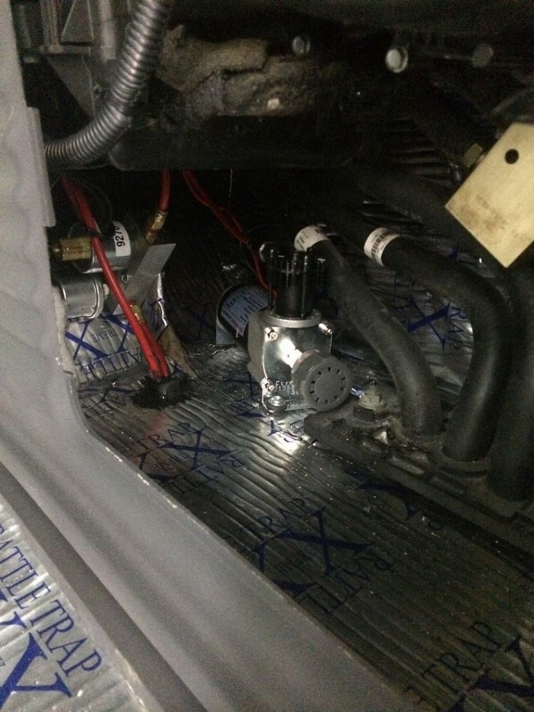

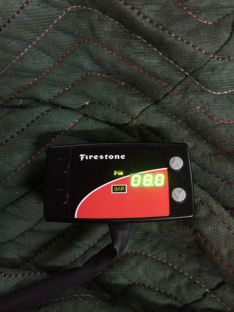

Rear usb's installed, LED revers lights installed, started on the Firestone rear air bags and compressor, got the compressor, valves and all wired, installed some panels and uninstalled panels.

Passenger side third row usb

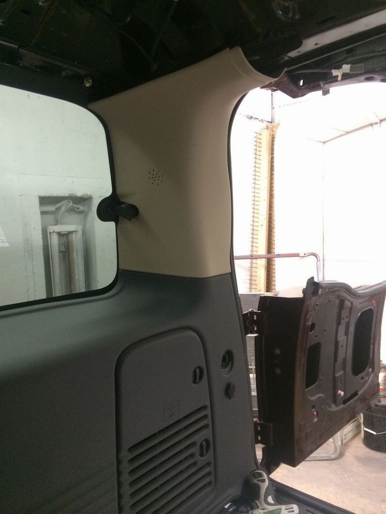

Uh, it looks like you forgot the headliner before the top trim panels went in :lookaround: Just messin'. LOL I know you are aware

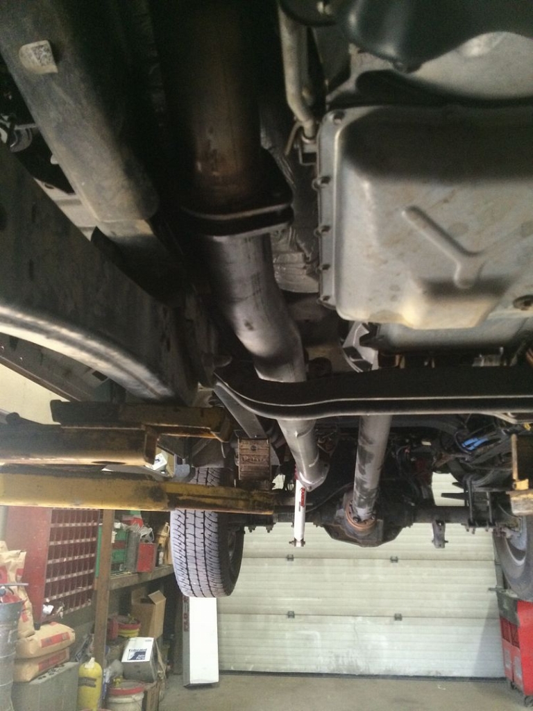

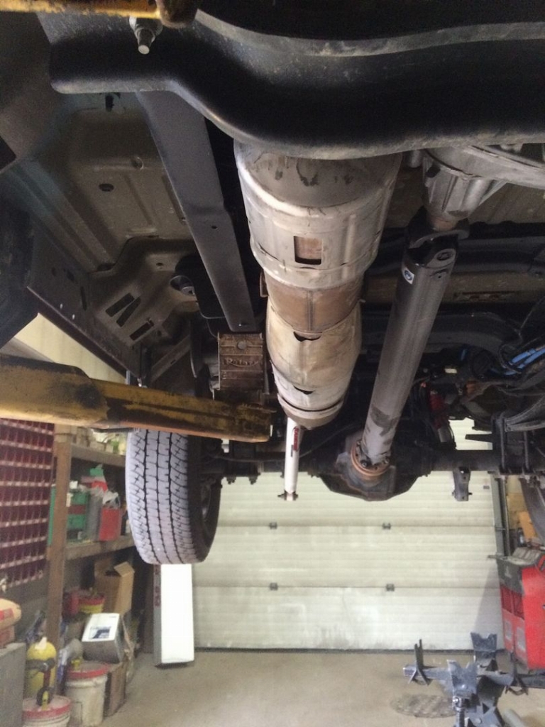

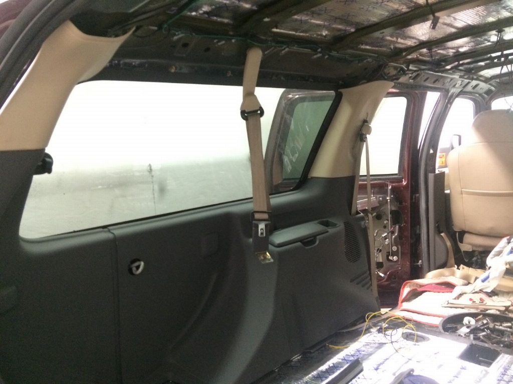

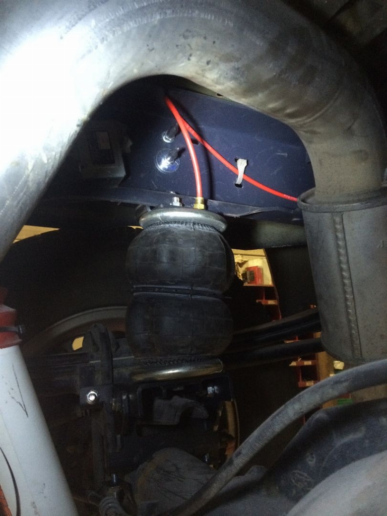

Ran air lines for rear airbags, put back gate and doors together, put running boards on, remove DPF tank and exhaust, tunned with H & S Mini Max
Air Out

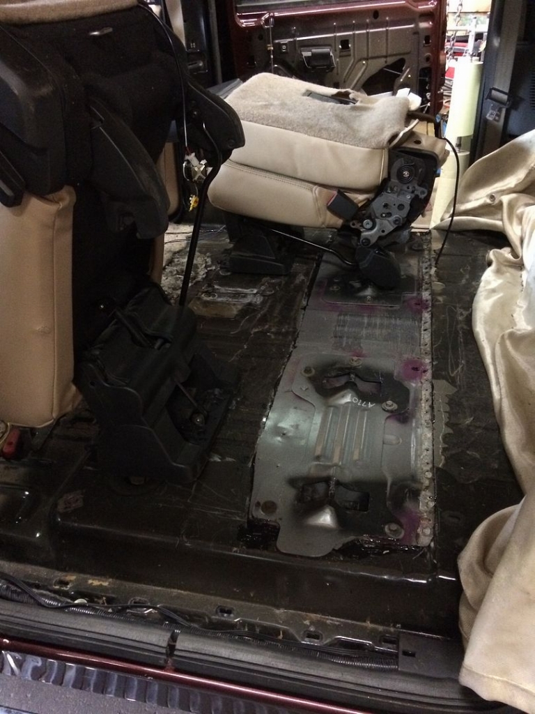

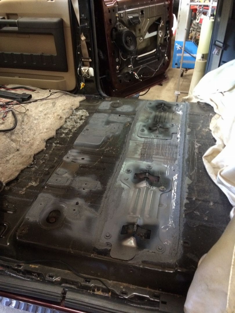

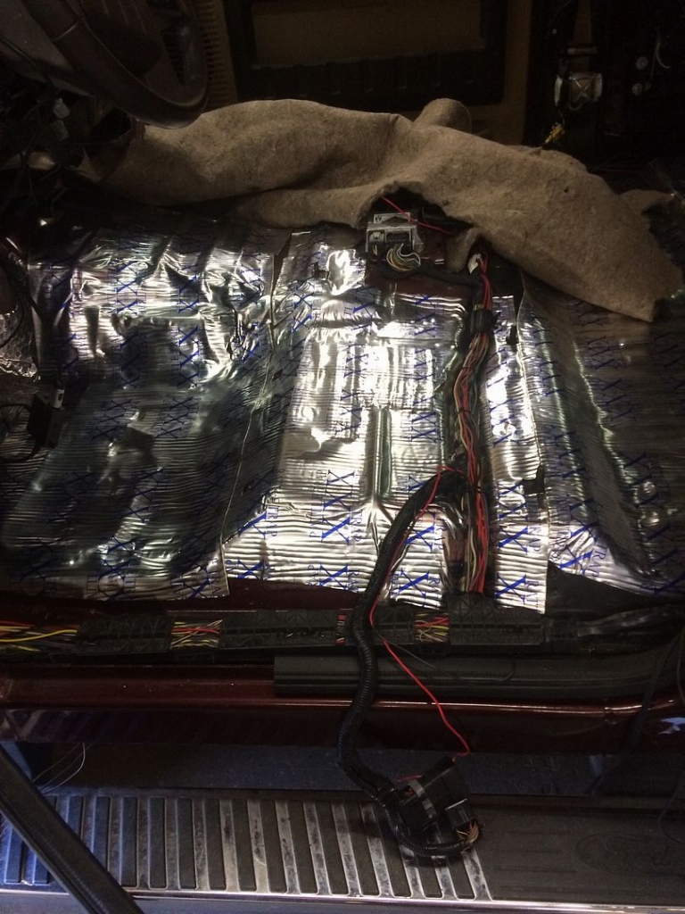

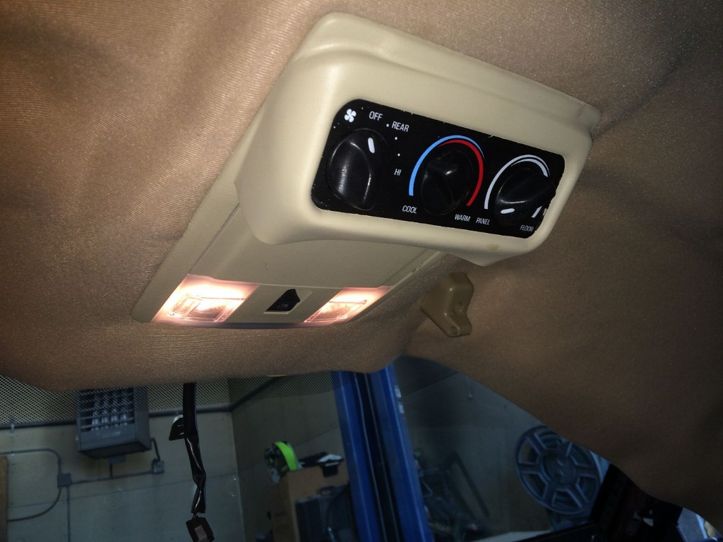

Deleted the EGR, got the carpet in, headliner back from being recovered and fabed up the rear heater controls on the 12 over head console.
Egr before
No egr after
Over head console
Sound detonation carpet backing

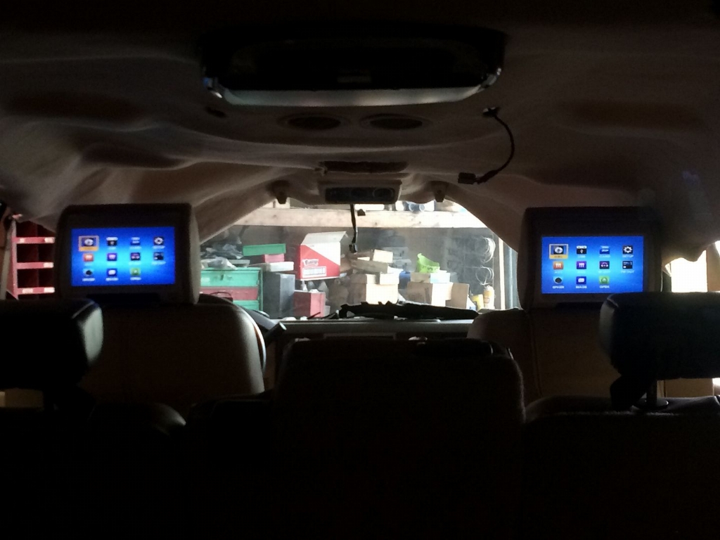

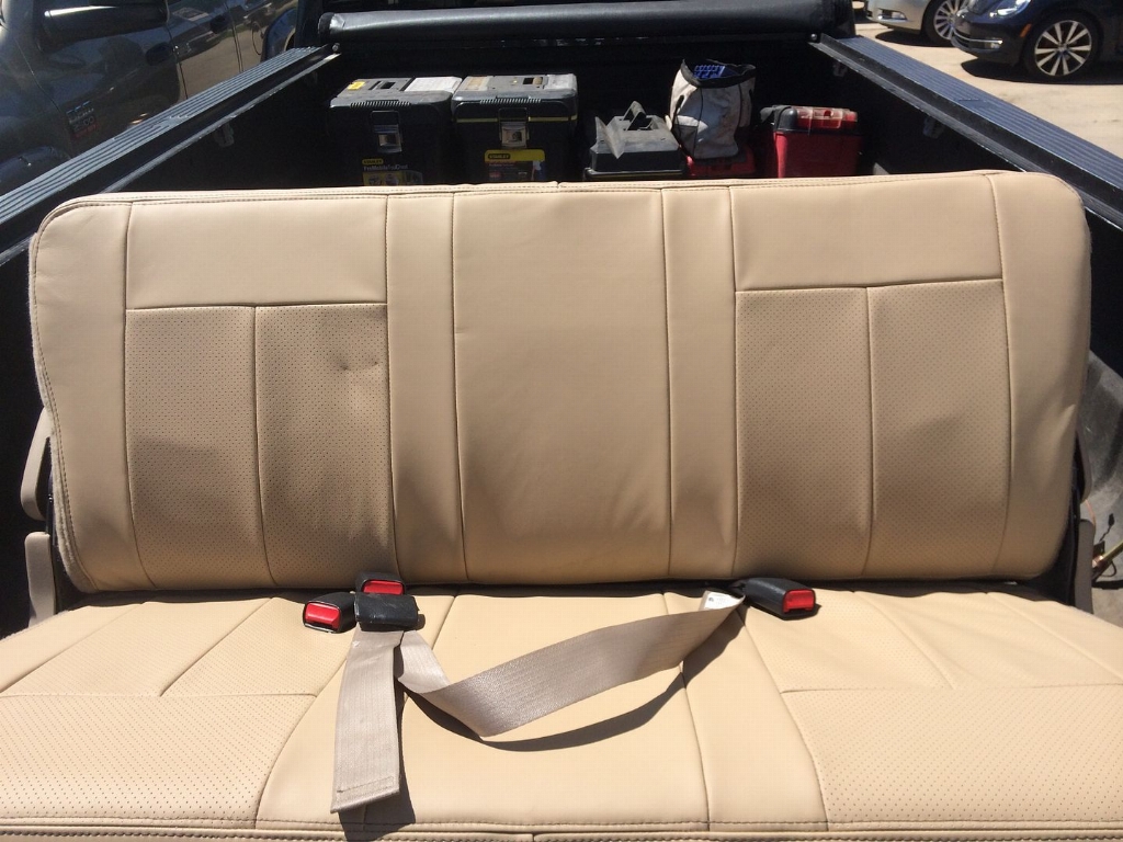

Front and rear seats installed, Headrest DVD's installed and wired, usb plugs installed and wired, heated seats all wired and working.

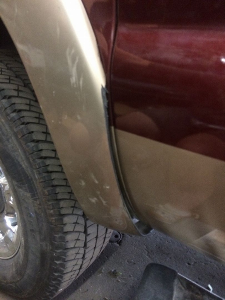

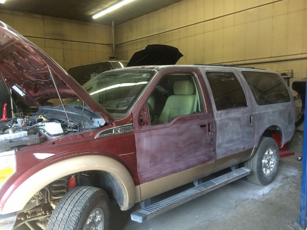

Not light on the base. Four coats of base and can still see the black coming through. Should of used a white or gray first before the base. Lesson learned.
