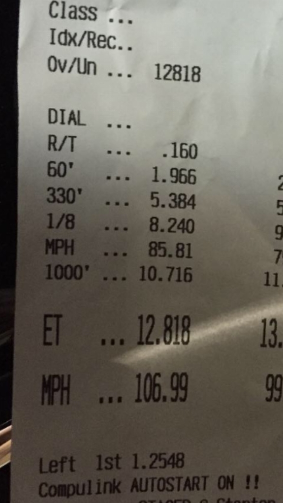

Left work late and went straight to the track to meet the crew tonight. Got there around 8pm. Did not adjust air pressure or anything else just got in line. Only was able to get one run in because the place was so busy tonight. Truck ran great. The 369sx impressed me most by keeping the EGT's down to 1365 deg max. Still have 2 more fuel settings I can go up with this Tune but there was no more time. I will have a video to post later but it was to big to download on the phone from the Gopro.
dseitler
Feb 2, 2014
812
Royal Palm Beach, FL
Nice, still alot left on the table if that 60-ft drops some. 107mph is impressive
Yeah with the stock tires I normally drop the air pressure way down. I did not launch as hard as I normally do with this being the first time I have run since the build and the truck being apart. I also am looking for a used set of 22X10 for race only because I picked up a set of Toyo Proxes 305/45R22
What weight Dan
8530lbs normally, but my 60gal Fuel tank in the bed was full and I had all my work tools with me. I literally drove from work to the track because we were so late.
