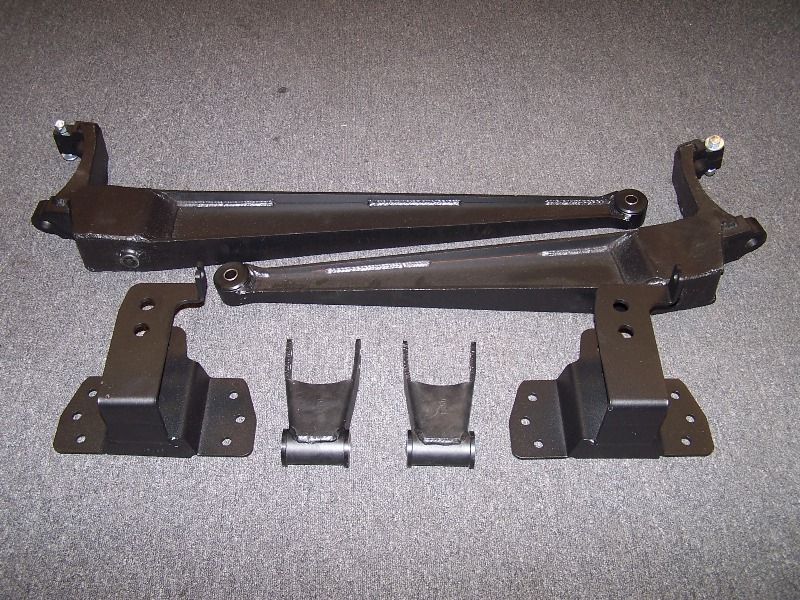

Oh boy...looks like I've got some work ahead of me! The very first hanger and shackle lowering kit produced for an 08+ truck (that I know of)...hope it fits right considering how much fun it is going to be to get the factory hangers off the frame. Thanks Ford for deciding they needed to be welded AND riveted!

Awesome! Can't wait to see pics, this be a 3/5 drop?
Yup. First of its kind. Congrats!

They are calling it a 3/4, I will measure carefully before and after.

You'll need every bit of a 22" to make it look right. The 6.7 has a large front clip that is hard to pull off with anything smaller.
