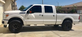

What up! I picked up a 2014 short bed F250 platinum a couple weekends ago. I measured front and rear and this thing is dead nuts level. I like to have my super duties sit about 1" higher in the front. So, I've always done 2.5" coil spacers on my previous Powerstrokes that were XLT and Lariat models. I did some research and read somewhere that the Platinum 250 short bed comes stock leveled? Does that sound right? What can I do to get that nose 1" higher? It does not have any sort of spacer under or on top of the front coil and looks 100% factory untouched.

My 08 was level from the factory, not sure how or why. But my 17 definitely was not level. Both 250 ccsb

My 16 sat pretty dead level.
Go with a 1" or 1.5" coil spacer for the front if you're after a nose high stance.

Most 250s are level. Mine is.

Depends on the package it comes with. My 250 came with 350 blocks so it sat nose down substantially. Now I have the 2.5" icon lift and it's still 1/2" roughly nose down.

Wow! Good to know! I'm thinking I might go with a 1" coil spacer if I can find one otherwise I'll do 1.5"

Depending on how much you want to spend, one up offroad makes an adjustable coil leveler and you can dial it in however you want up to 2.5".

I may consider that then! That sounds like I did on my F-150 with the Icon Coil Overs
