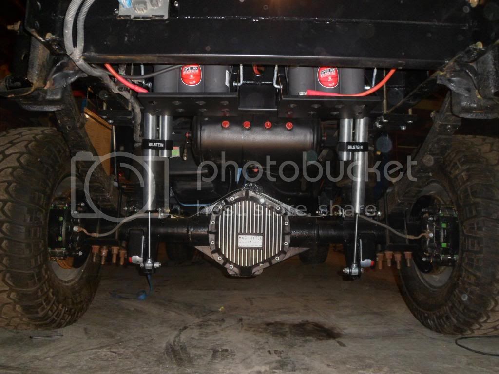

Why not cut out the rear tire carrier and install some new cross braces that allow you to tuck that fuel cell up higher and maybe even add a little more capacity?

I suppose you could but then if you only had a crossmember on the top of the frame rail you would loose a lot of rigidity.

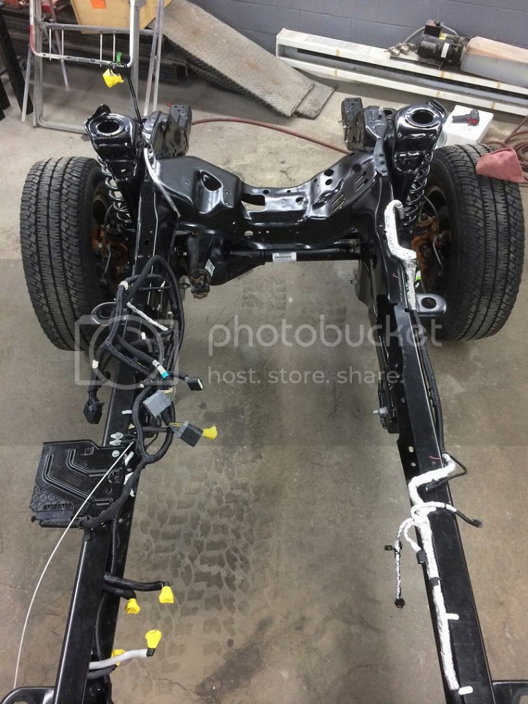

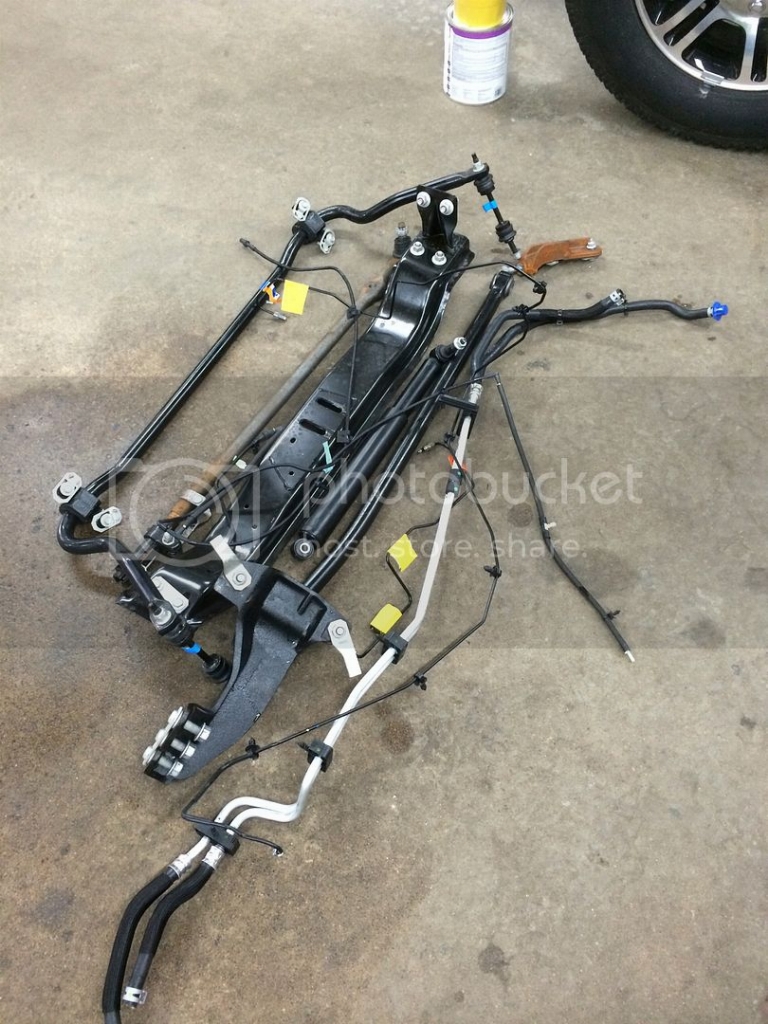

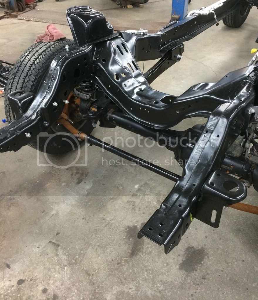

So with the cab, box and engine/trans all removed we could finally see what we were working with. Ton of fuel lines, pigtails for emission equipment and fluid lines were still on the truck if you could call it that. We pulled the steering gear, track bar, etc from the front to get ready to throw it up on the stands.
Not even 50 miles and the tie rod ends, knuckles and the axles are completely orange, everything else was nice and clean however.

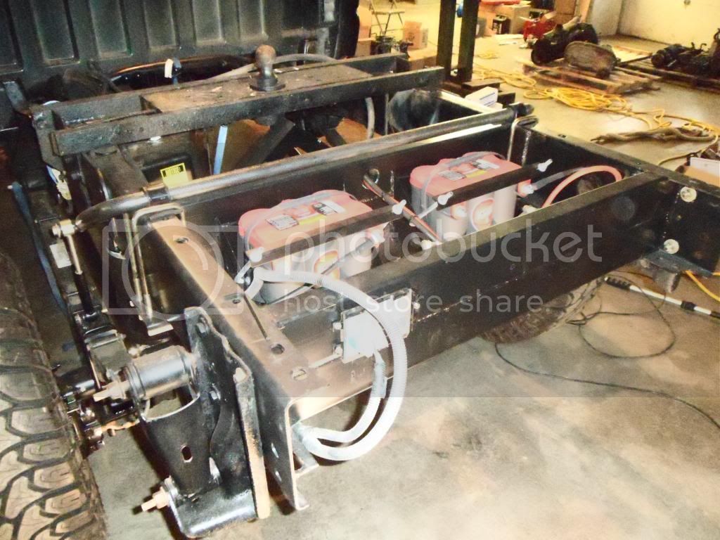

I'm not saying put cross members just across the top. I'm saying cut out all that spare tire wasted space and weld in some 2x8? crossmembers that you can use to tuck the fuel cell up higher because it fits cleanly in between.
Kind of like this setup where it was removed on a Chevy truck and made home for some batteries, air tank, and made some new rear shock mounts:

Certainly could do that, but we have a setup here that we were both and still are happy with. 35 gallons is enough for me, I'm sure we'll use that available space above the fuel cell for something.

Because they said the factory tank would interfere with the new suspension.
You are correct, it would have been an easier alternative to run one of those huge titans but that would interfere with the movement of the upper link setup.

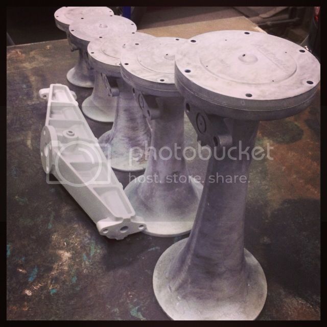

Slight derail from the progress on the truck, I got with Josh again at The Diesel Cartel to get some more parts. My plan is to have everything here that needs to be mounted to the frame so we can place everything before disassembly and paint. With an airlift it was borderline mandatory to have at least some type of horns on the build, the air tanks and compressors are necessary anyway. All that is needed is the horns and a valve of some sort. Josh hooked me up with some Nathan K5LA horns, there is plenty of other horn options out there but I wanted one of the loudest and cleanest setups available. Since all 5 horns bolt to one manifold it made sense to go with these horns.
I already knew the horns were going to need some work to look good, they showed up looking pretty ruff. With 3 layers of paint/powder on them they had seen better days,
Unfortunately our gun cleaner only took the first 2 layers of paint off, the last powder coated layer was on there. We sent them out to get soda blasted, I couldn't believe how they looked just after that. With some more prep work these horns should look awesome all said and done.
