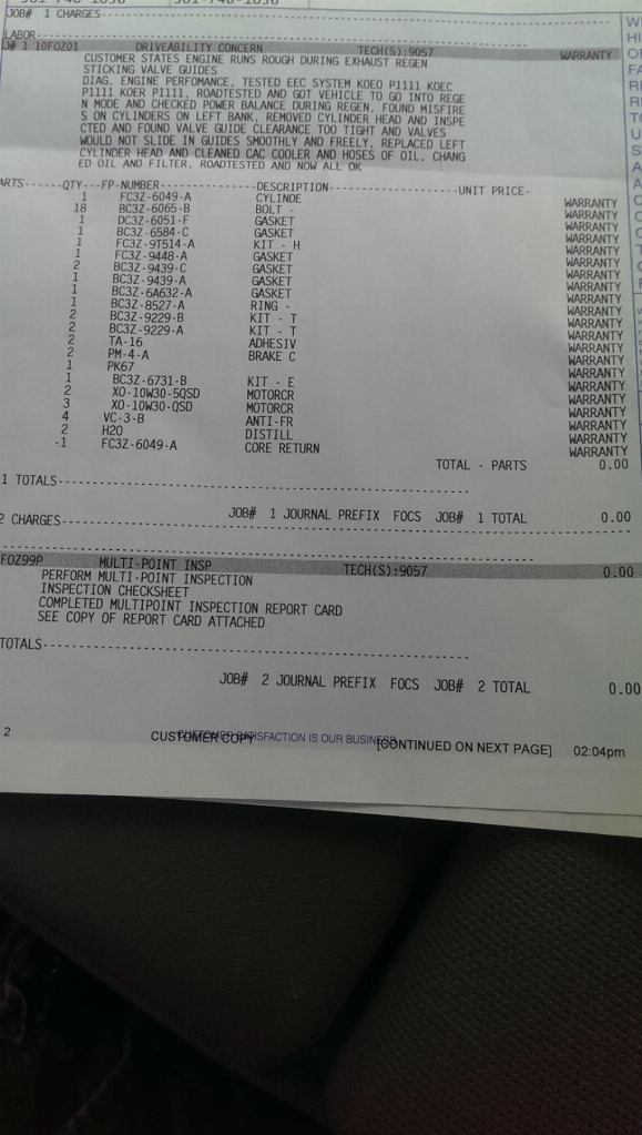

The repair order below is from a 2015 owner who was fortunate to get Ford to replace the entire left head of his engine. After 11,000 miles, for this customer, the fix has thankfully been successful.
This repair order has had several thousand views on other forums.
