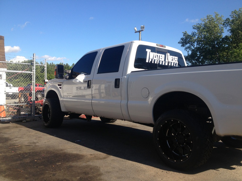

Just got my 20x12's with 305/50/20 420s on today. With 4400lb coils up front. Barely touches the fender liner at full lock, so I'm fine. No need to trim anything on mine

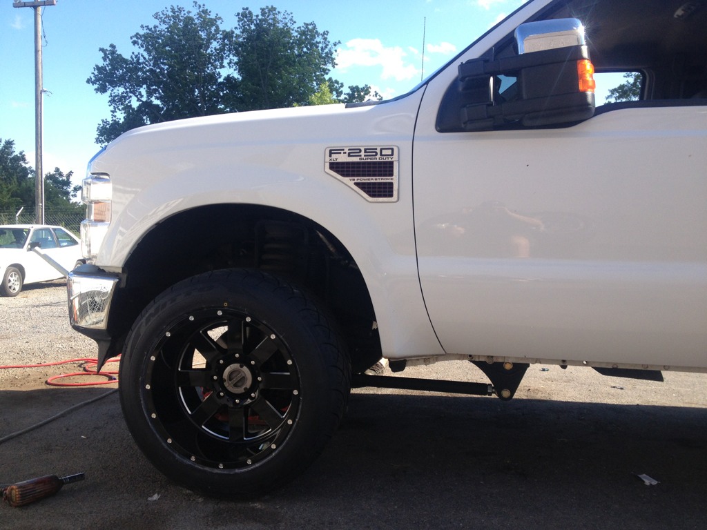

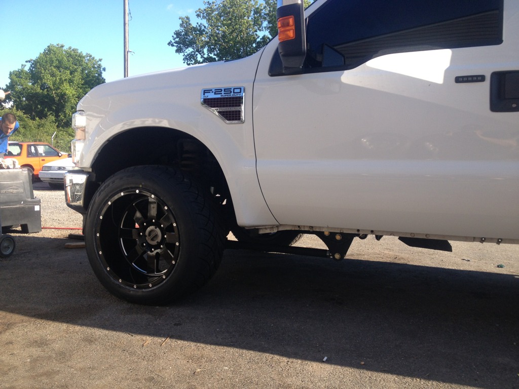

Stock height with pmf short arm 4 link and 20x12 moto metals with 305/50 420s
