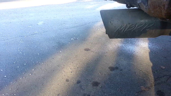

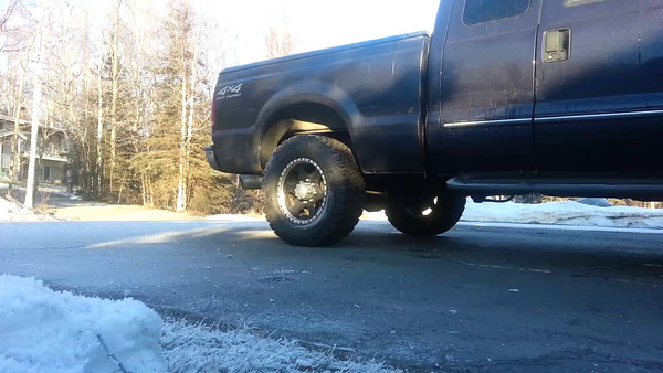

Gearhead Hydra tuning "All Out" tune
Unlimited 400cc/200% injs
18F air temp
12F oil temp
overnight, no plug, not driven in 5 days, truck has been driven 17 miles since HG replacement, probably still have some air in the HPO sys.
After 5 minutes of idleing (Gearhead "Whisper" tune)
Gearheads Hydra tuning with the new 4 line is the best my truck has idled...ever. I'm sure other tuners have idle figured out too, just posting my experience. The reason for the engine compartment shot, is to show no "shake, rattle, and roll" like I've had before....he'll probably say it's the same tables, and he didn't change a thing now :) ....but I'm just sayin'
