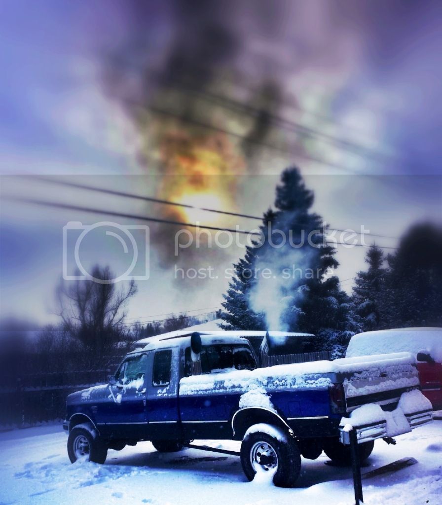

200 nozzles, no air heater, new turbo, fresh motor, no matter the tune or tuner and the truck still smokes pretty good when cold until the oil temp is about 80ish. the smoke makes for a cool photo when its cold out LOL
this is after about a ~10 minute warm up
