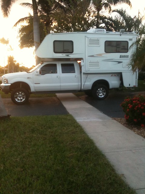

Im running a 4" lift on my 03 and had to go to a 33 so it could flex more. The 35 would always rub when off roading.
Here you can see I can tuck a 33.
Untitled by MooringProduct, on Flickr
My tire stays centered when loaded..(3300lbs)

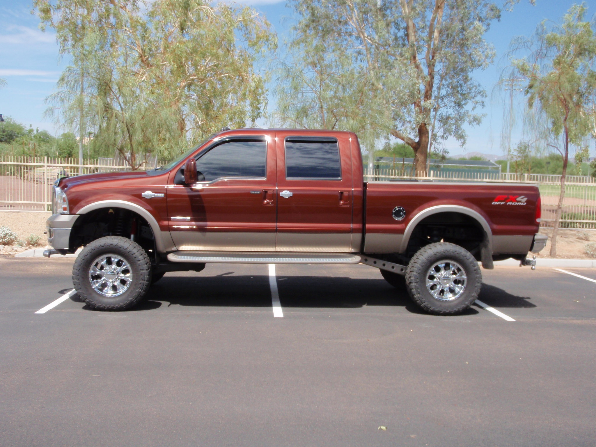

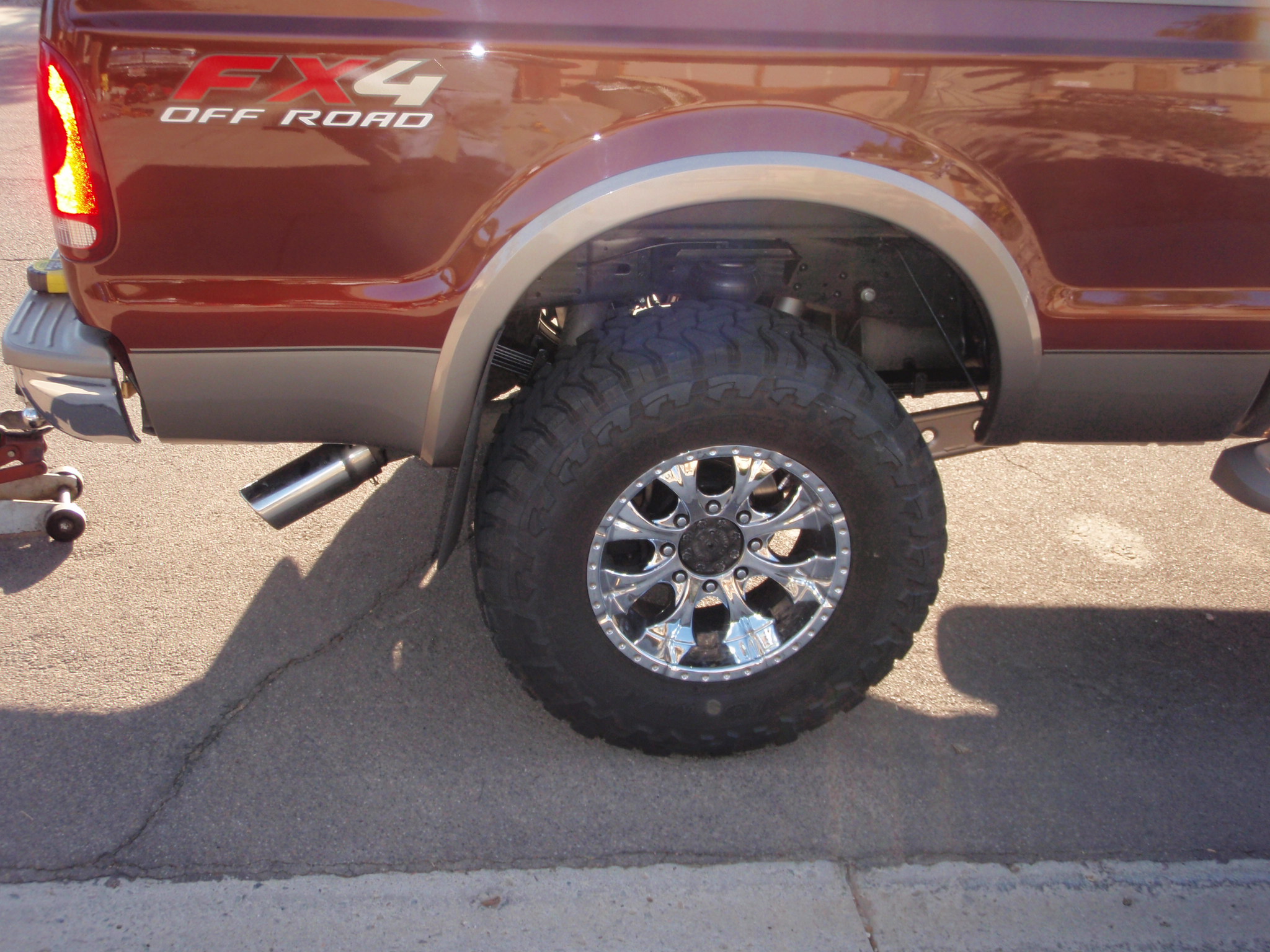

Figured id update this. Spaced the front bumper out a bit and pulled back the fender liner. 37x20 on a 4" pro comp lift.
Sent from my DROID BIONIC using Tapatalk 2

I trimmed the bottom of my front bumper, dont like the look when they are spaced out.
Works great huh... Fills the wheel wells too!
2000wa250
Oct 15, 2011
1,048
Rubs on the fender liner when flexed and turning...other than that nothing. Joe I know what you mean by the spaced out, but it was easier at the time to space it than cut it. Plus I might have an add a leaf to add to the front and bring it up just a hair.
Yes I think these trucks look great with 37s. Completely happy with them
