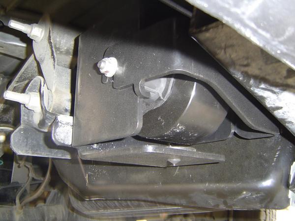

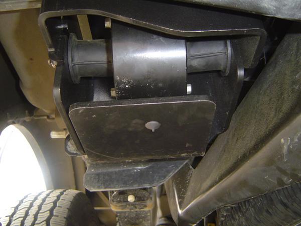

Repair.. check on drivers side of the hitch to frame mount, should have
cage damper..if not install one under warranty.

Its an elastomeric damper that absorbs harmonics traveling the length of the frame. That rear frame section is like a big tuning fork lol
