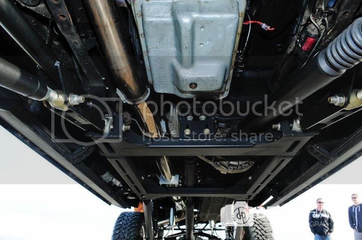

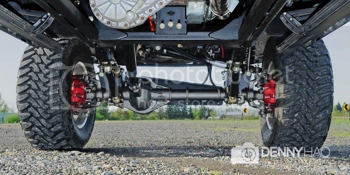

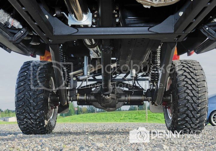

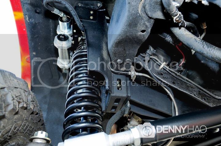

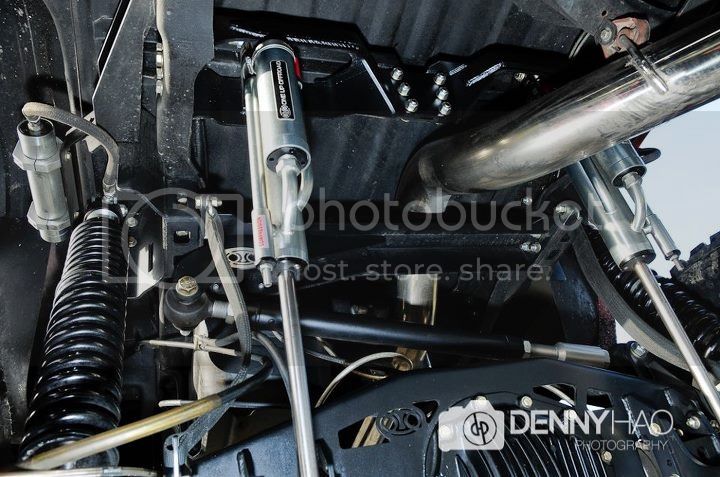

Here are some pics. The paint on the driveshaft is partially dried. I swapped out the rear swaybar for Hellwig Big Wig bar. Waiting to put the truck back on the ground to adjust the end links.

Any chance you could take a picture of the driveline. The end connection, then at the carrier bearing and at the transfer case.
I just saw this. I will get you some pics later today or tomorrow.

Your driveline looks different then another one I looked at.... Interesting....

Layson and GNXTC2 both of your trucks are so freaken clean I can hardly believe it.
Layson how much suspension lift do you have on your truck ? I see you are running a sub-frame inside your frame rails. Pretty impressive, and it looks to me that GNXTC2 has a auto lift in his garage. lol

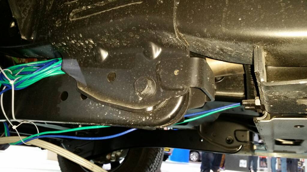

Went to the NY Auto Show and there was a 2017 on display. So I laid on the floor and snapped a few pics of the front hangers. Looks like the radius arm mounts were beefed up.

Dave and I did a bunch of measurements at Sema.. I cant wait to have ALA's on a 20 mile 2017 truck. Lol

looks like Ford could have spent a bit more focus on the wiring. I doubt that'll last even the most laid back mall crawler long.
