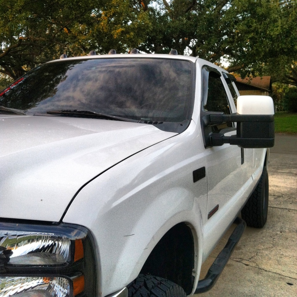

Really liked this picture for some reason

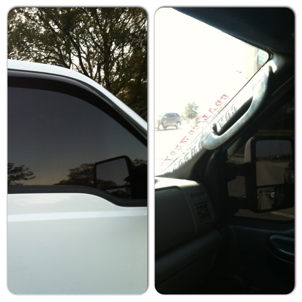

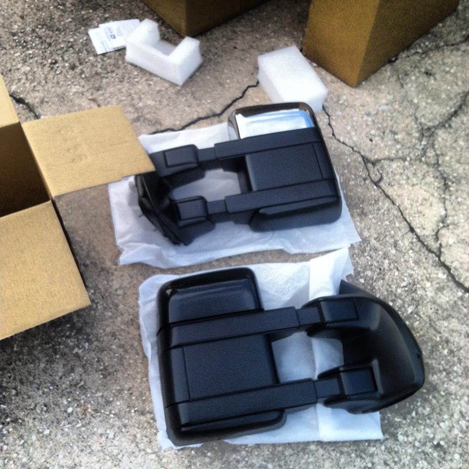

The mirrors from 1AAuto.

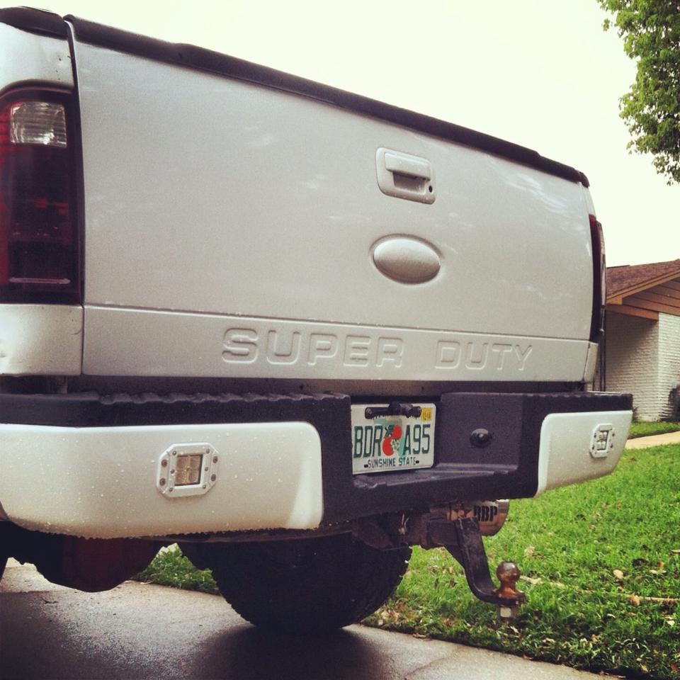

08 tailgate and tail light conversion. Still trying to make a decision on whether or not to shave the Ford emblem.

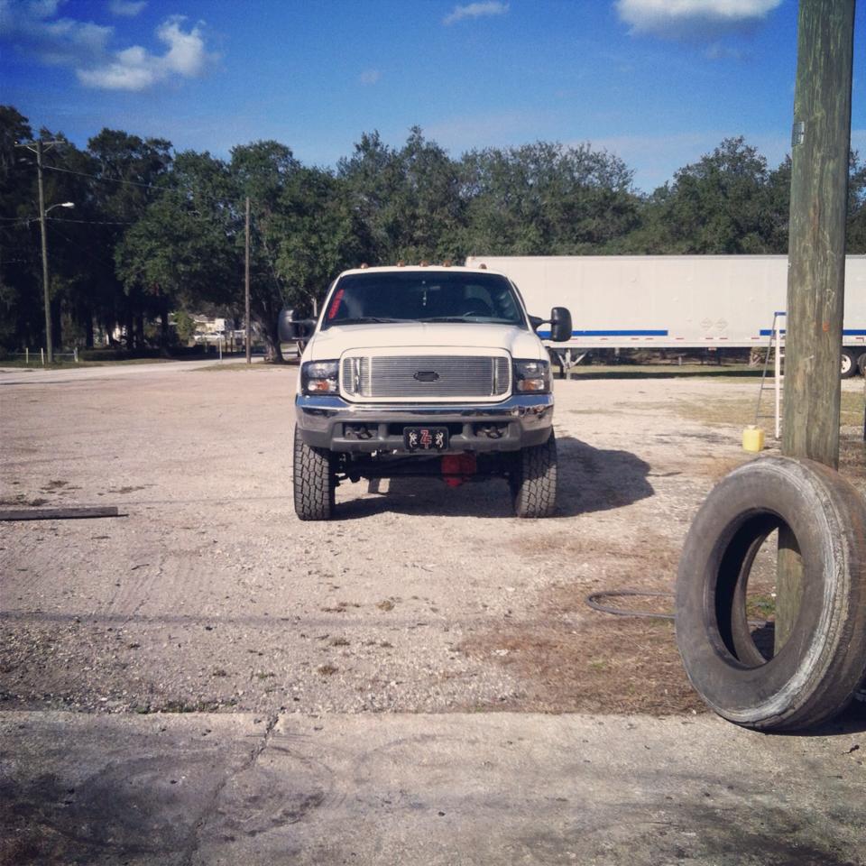

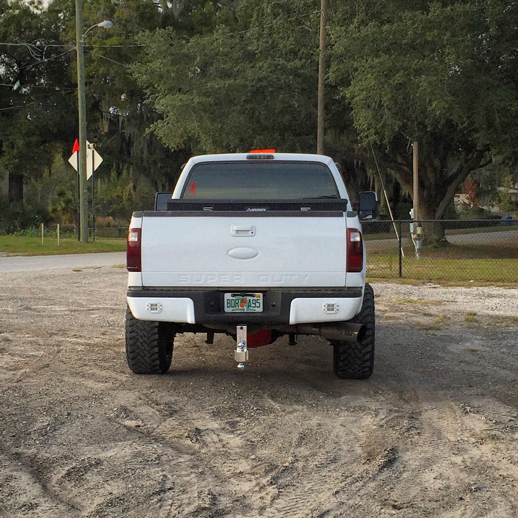

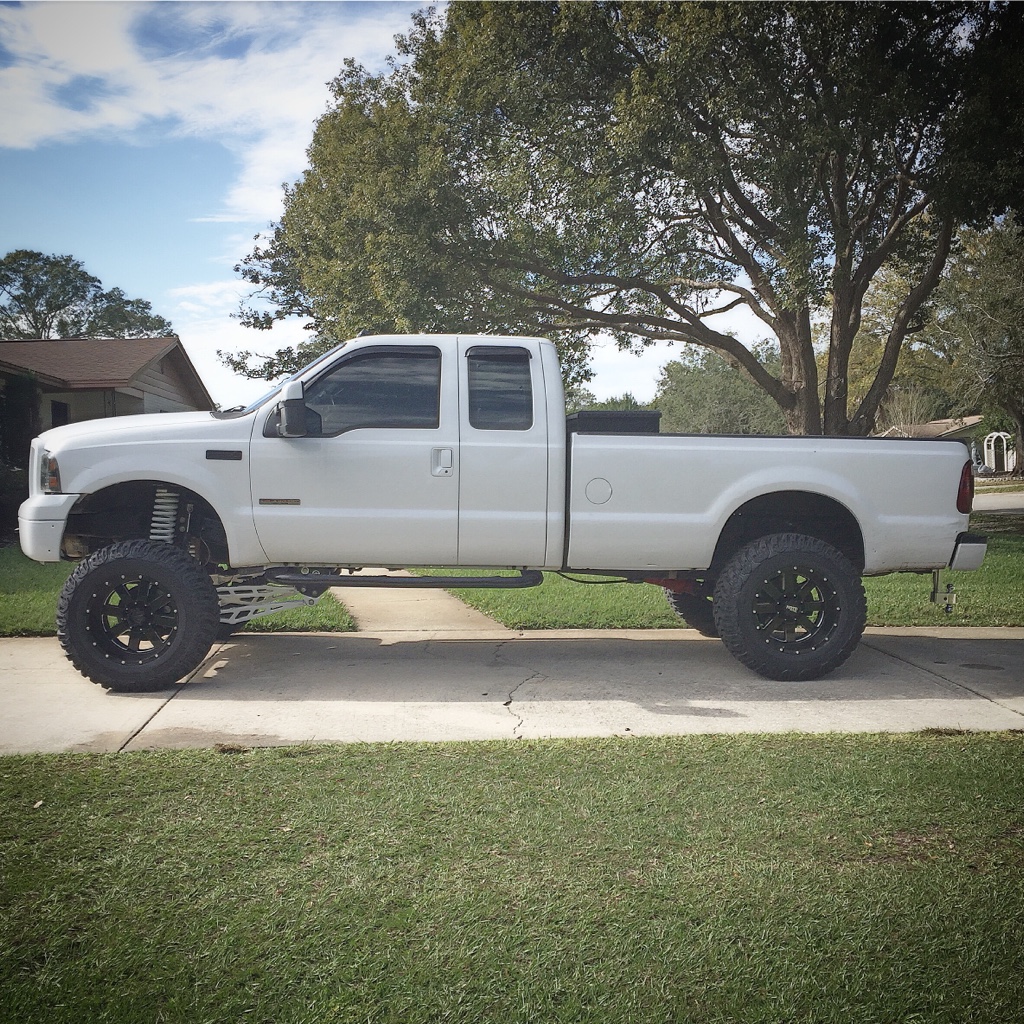

More recent picture

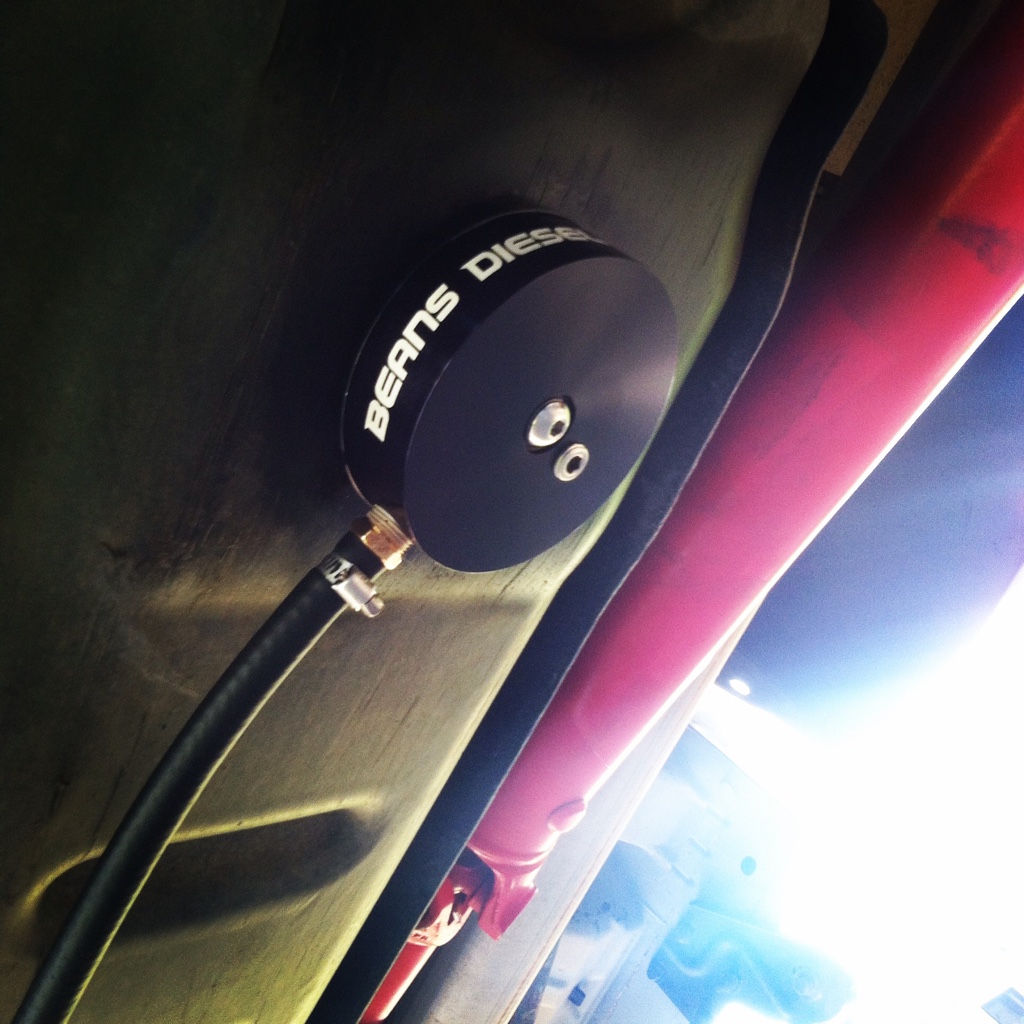

Bought a new oem fuel pump and it didn't change anything. Still 50-55psi and would drop pretty easily. Added a sump and pressure stays at 55-60 and only drops on wot when before it would drop on 1/4 throttle. It's got 200k miles so sediments probably clogged the pickup tube.
