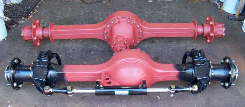

Haha I had this pic saved since I'm trying to find a set. This might be a lil overkill LOL

Wow that's a batch of bad luck. I say next it military style axles with the ball and socket type knuckles (don't know the technical name for those style axles) couldn't tell in the pics but did you have sled stops?
