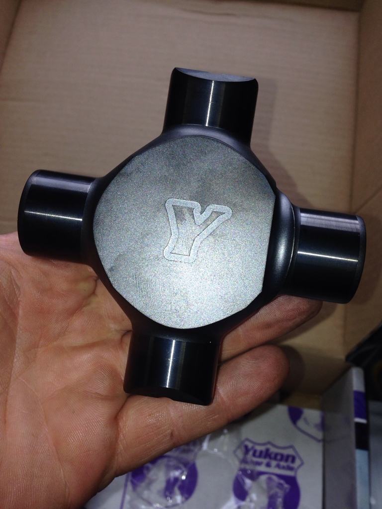

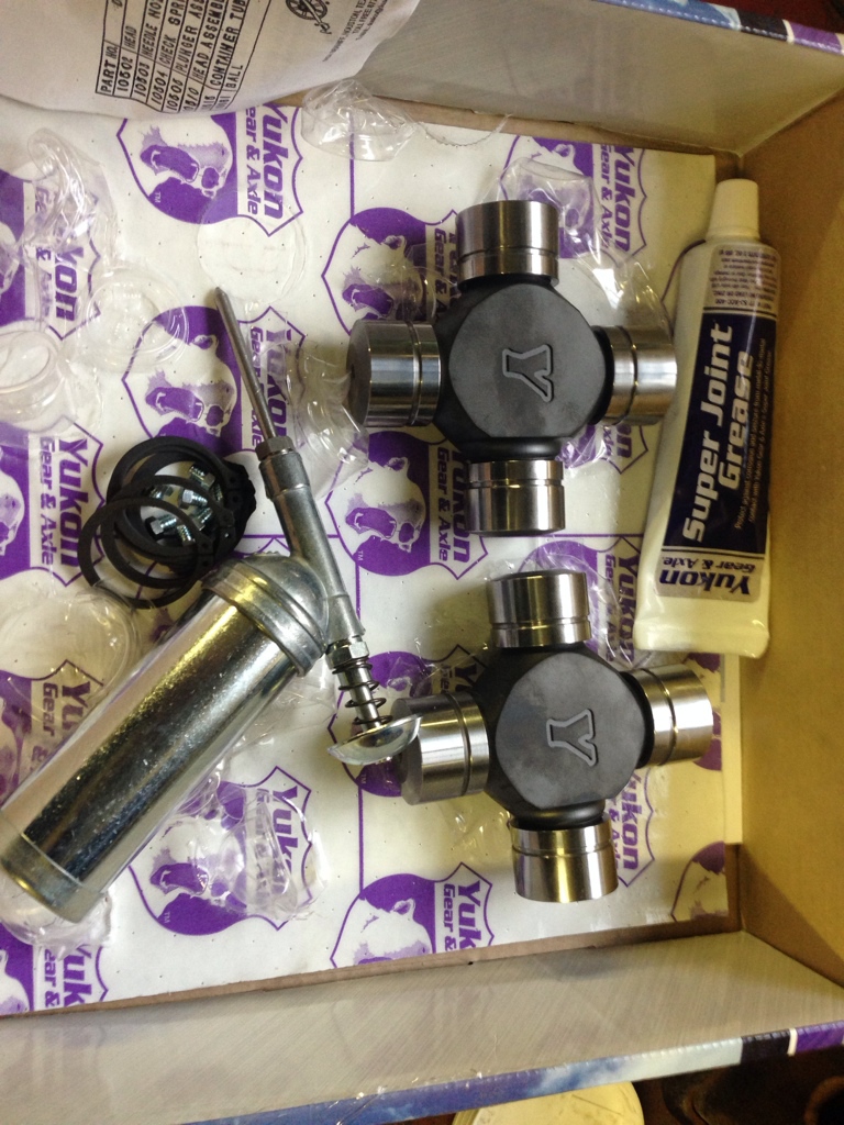

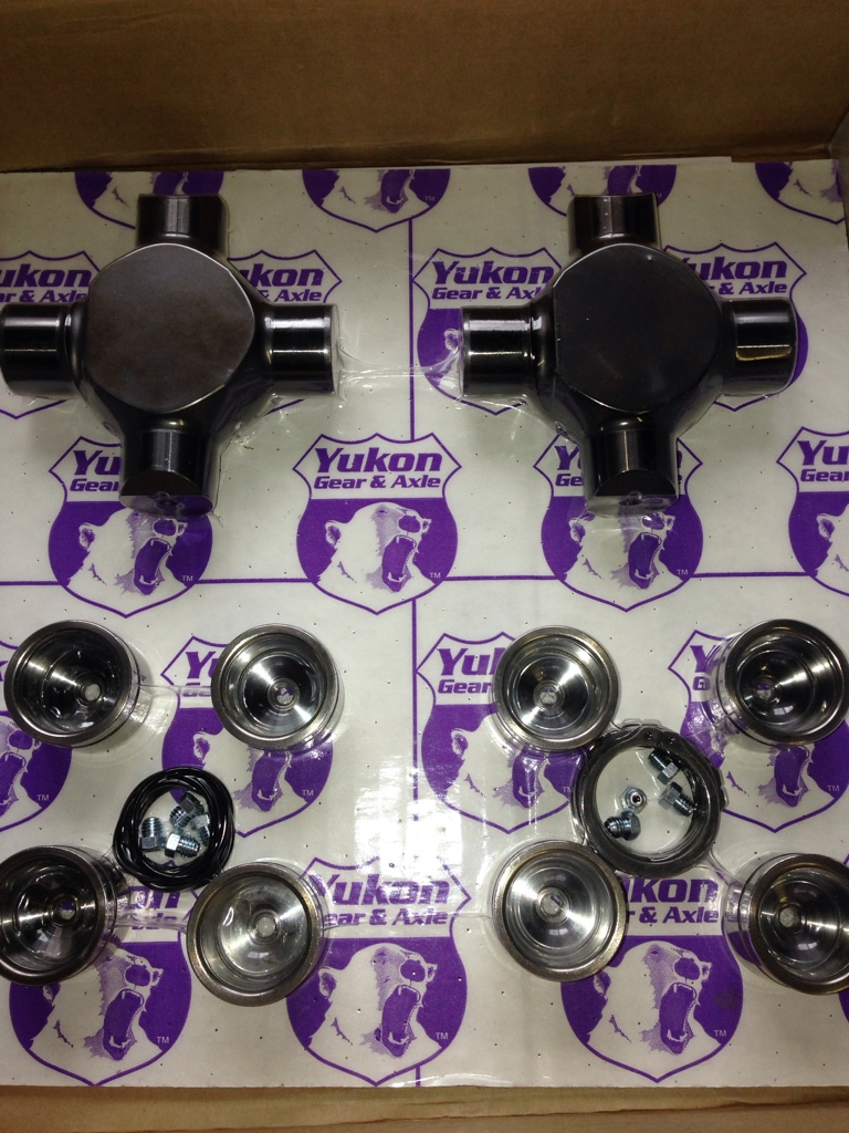

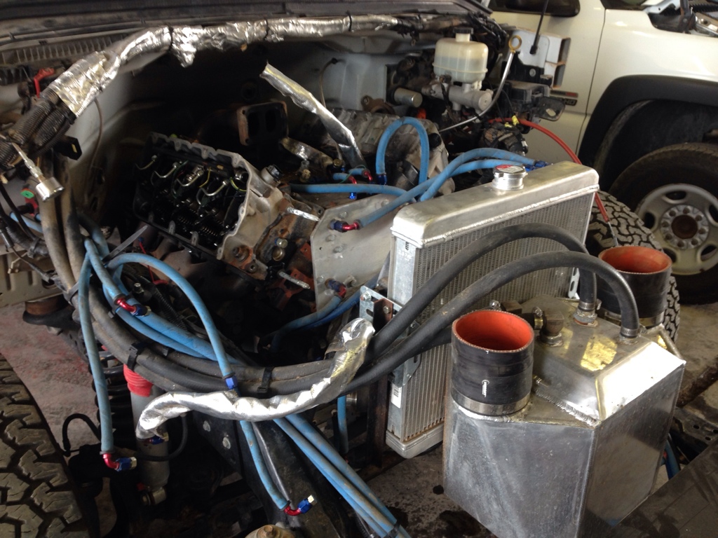

These should help
ford141
Jun 27, 2012
92
Wasn't there a similar failure like this at a pull in clarion PA, Eric George's 6.4. he broke the ball joints and he developed a nice stance (little joke there) I wonder what he did to remedy the problem
I believe he just replaced them with new OEM ball joints. That front axle took a beating for years prior to this as he battled front axle hop, so there was no shame in a ball joint letting go. I've seen that front axle off the ground on numerous occasions.
