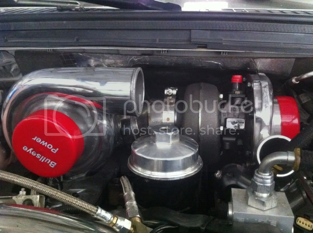

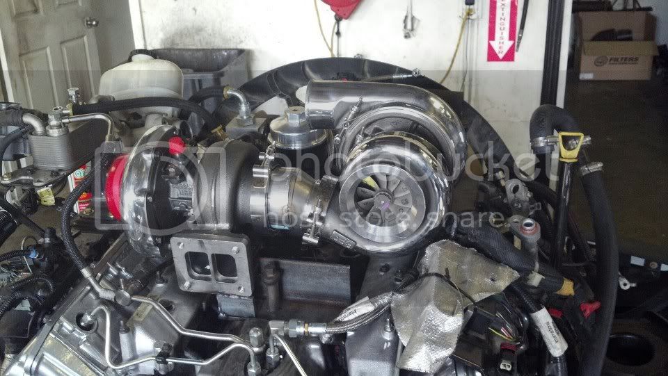

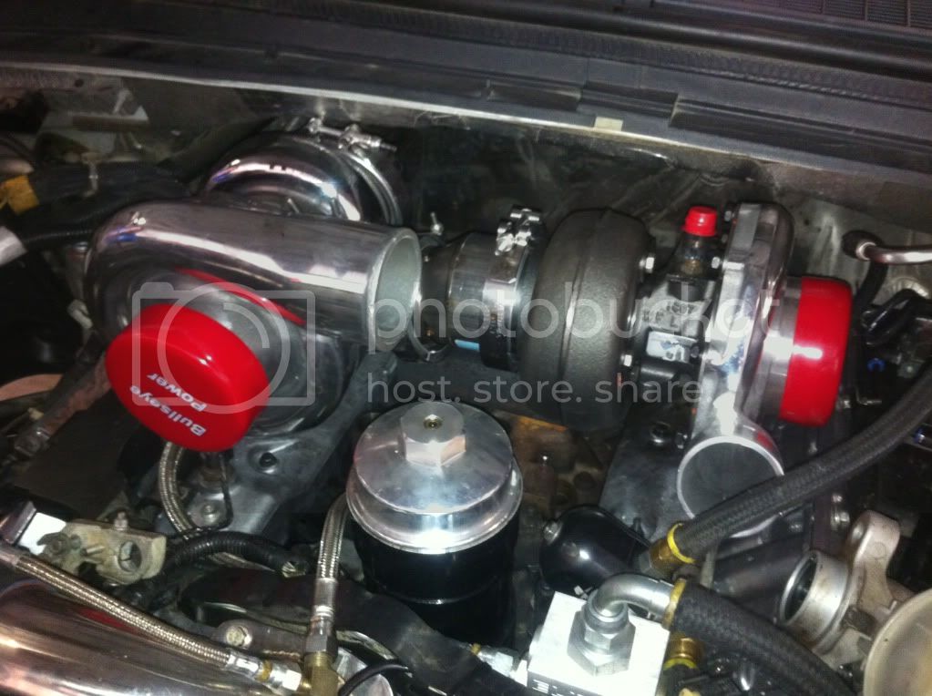

Corb, I hope this works out as well as planned because I think we both know who will be getting the second set.:cool: Can't wait to see the results and having access without removing the cab is going to make this set up awesome. :popcorn:

It's a knuckle scratcher, but technically the high power and max power turbos can be changed cab-on. I imagine this setup to be setup to be similarly difficult.

Yep. I've also changed out a set plus an intake manifold cab down. I didn't have too much trouble doing the turbos, but the intake was no fun. I'm sure it would be easier next time on the intake, but given the choice, if I had to do an intake manifold, the cab would come up. There's just a lot of wires, fuel lines, heat shields, etc that get in the way of the intake. If it's a turbos only deal you can bet I'd opt for cab down as turbos can be changed in the time it takes to pull and reattach a cab though. The right tools definitely help as well.

No doubt. But the way the housing sits near the back, and blocks off access to the other crap back there, and, limits you to a 4 inch down pipe, is something that I want to avoid. Mine should have a 5 inch, from turbo to tip exhaust pipe. (with a slight bend around the trans cross member though...)

also, if the turbos that we picked out aren't enough, or don't put put as we hope they do, we can now have access to everything we need to change locations, and sizes, without lifting the cab.
