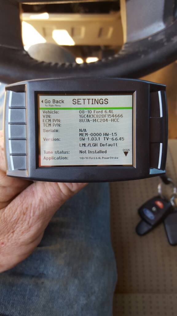

Ok I had the PATS unlocked again yesterday... I hooked the new tuner up again with updated sd card, changed vehicle in tuner, updated firmware, and tried to tune... As soon as it asks if it's an auto trans get this wether you select yes or no it does not matter...
So I go to show settings in the menu and it shows this... GM vin and for a LML 6.6 and tune not installed... It came of my buddies Chevy and he bought the tuner new...

I assume you have already Gone to menu>change vehicle and select 08-10 6.4. Then go menu< install download?

it's not talking to the PCM. when you first go to load it, it communicates with the PCM and retrieves the VIN and strategy. If the PCM is sending zeros to the cluster as a VIN, it might kick a security issue due to VIN mismatch?
with the old tuner it wasn't kicking the PATS until it finished loading and said to start vehicle... It still has all the correct info showing in it...
