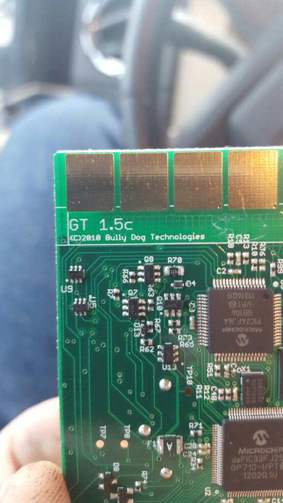

Popped the cover off my old mini max and found this on the board...
Makes me wonder if you could use a bully dog gt and load h&s tunes.....
sent from the best place on earth! TEXAS!
It can be done, but those are the ones with all the issues ( wiped BD's that is ). Every time I read one of those stories it ends up being a BD someone acetoned the logo off of and tried to wipe clean and load HS stuff to.
