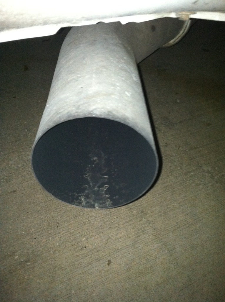

Here's the thing it only started puking when at the same time I had coolant residue in the exhaust.

Yea doing it this evening. Now my question is, on the lower cooler, how hard is it to remove? And can I put the coolant plugs in, remove the upper cooler cut the bottom flange of the upper cooler off, tig weld a cap on the flange and bolt the flange back on to the lower cooler (capped off). And leave the lower cooler on (with no coolant in it? If that makes sence.

Do it right, and you'll be happy. No guarantee it's the EGR, but I'd definitely start there, especially if the EGR outlet is wet. To do a full basic EGR delete we charge 4 hours, and that includes removing the brackets, and torquing in new exhaust manifold bolts once the lower bracket is out. The lower cooler definitely takes some finesse, but it's not too bad. I always remove the dip stick so it doesn't interfere. Good luck. Hopefully that fixes it.

Ok I will do the whole delete! I was able to change put both thermostats by my self. So hopefully I can do this! Lol thanks for your help

The coolant out of the tail pipe is a dead give away.
Good luck, Cory. They really are not too bad to delete.

Well got the Egr deleted both coolers were ruptured. Having to run straight distilled water couldn't get coolant anywhere. Did the delete with out removing the inner fender and is wasn't bad at all! I used RCD instructions.
Now on the way home I ran it pretty hard got the ect up to about 203. On a hard pull. And when I got home opened the hood and it did puke a little bit. So probley my headgaskets?
