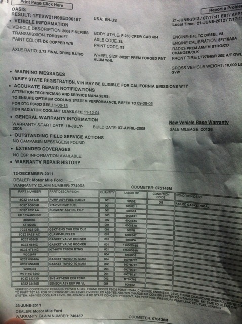

So... Went by to check on my truck. Service manager says "you have deep valve train noise and we need to go into the engine" but, then tells me they don't want to work on my truck because it's not a fleet truck that thy sold. Handed me my keys and a copy of my oasis and tells me to get it fixed else where pretty much. ImageUploadedByTapatalk1340389414.240855.jpg

Well at least they told you instead of taking it and letting it sit in the lot. Then finally getting to it and doing a crappy job. LOL

As you Can see on the oasis that 8,000 miles ago(right before I bought truck) there was warranty work done due HPFP issues and a overfull condition, the top of the engine was went into then. It's been no time since ford performed those repairs, I'm just worried when I get it home some douch bag service manager is gonna try and screw me outta my warranty.
