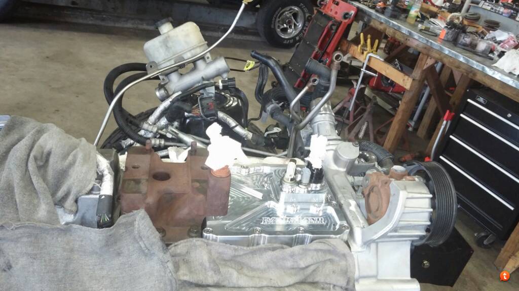

Taylor D
Jul 31, 2012
395
Sebring, Florida
Got the new front cover on and the mpd plate on and it looks awesome. Took the heads to the machine shop this morning should have them back next week.
