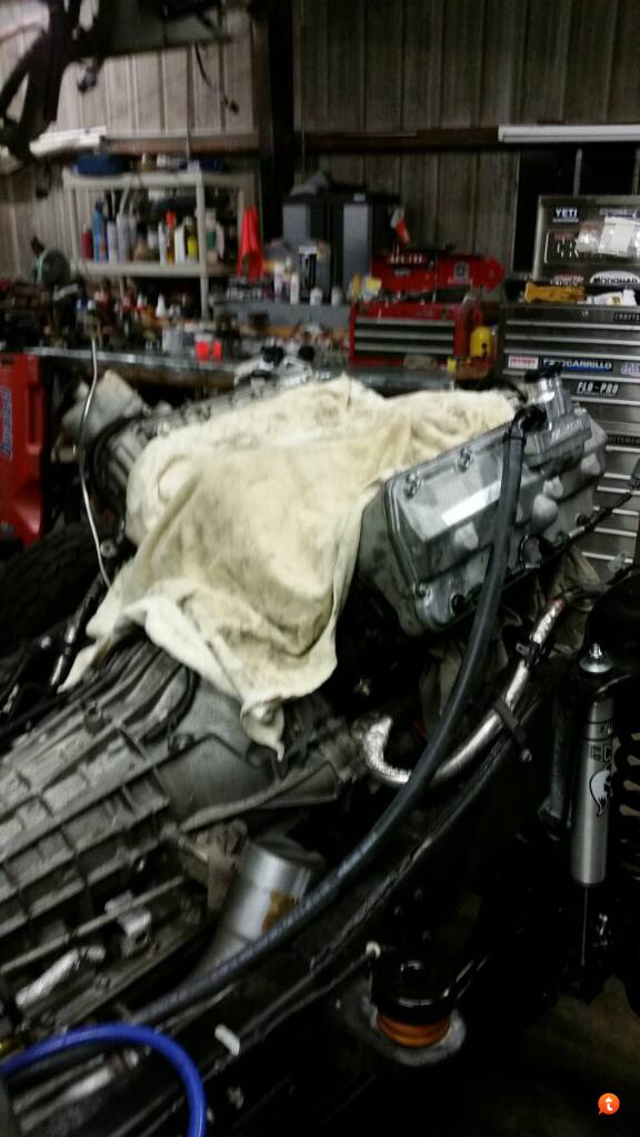

Well got the heads back on and everything torqued. Tomorrow night will be 3X intake manifold, up pipes and turbos. Along with hopefully completing Marty's fuel system and main engine harness install.

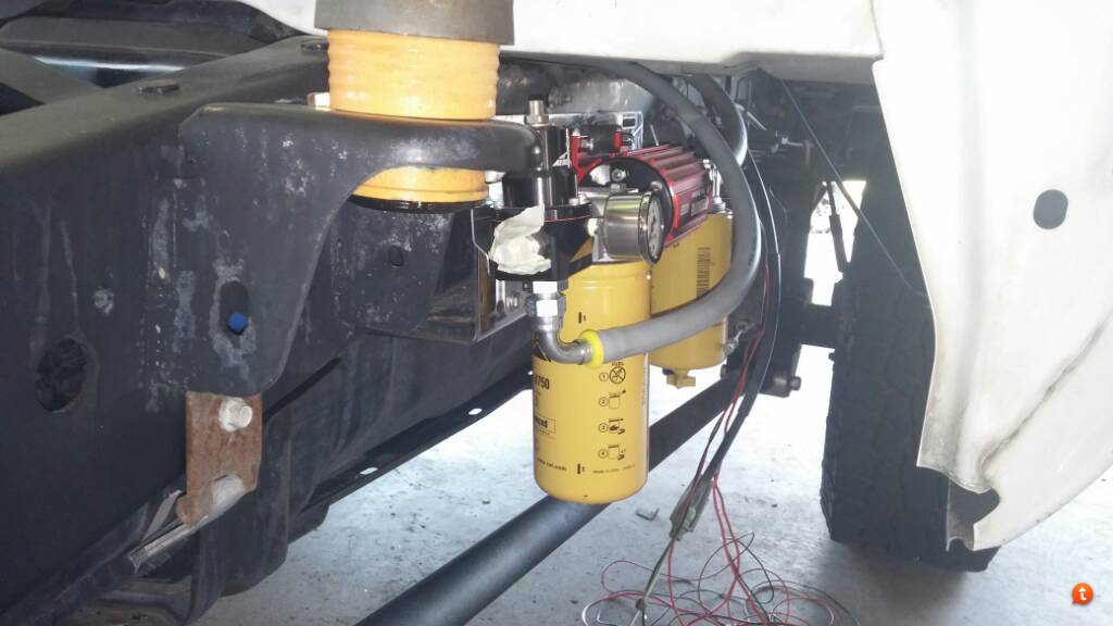

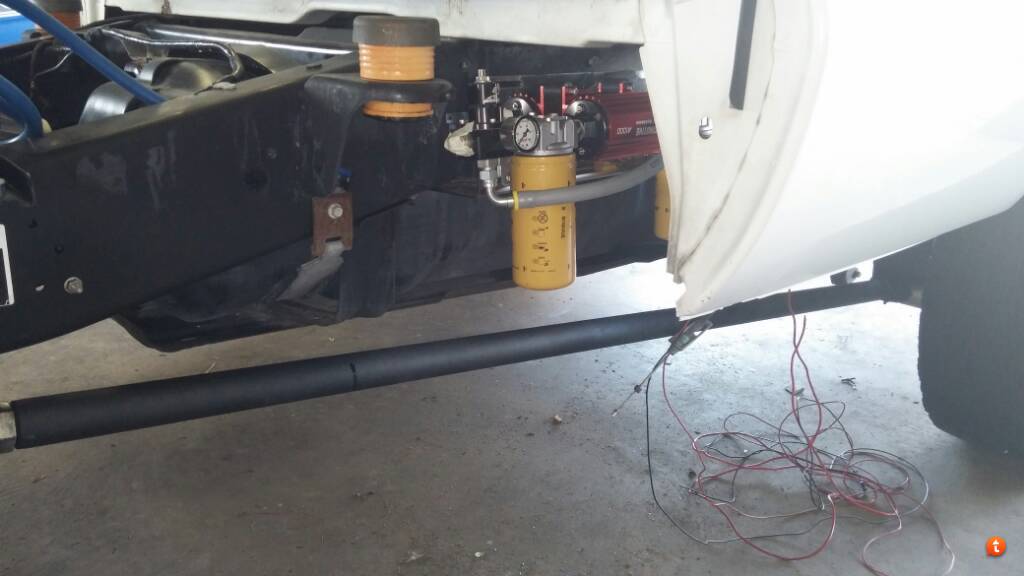

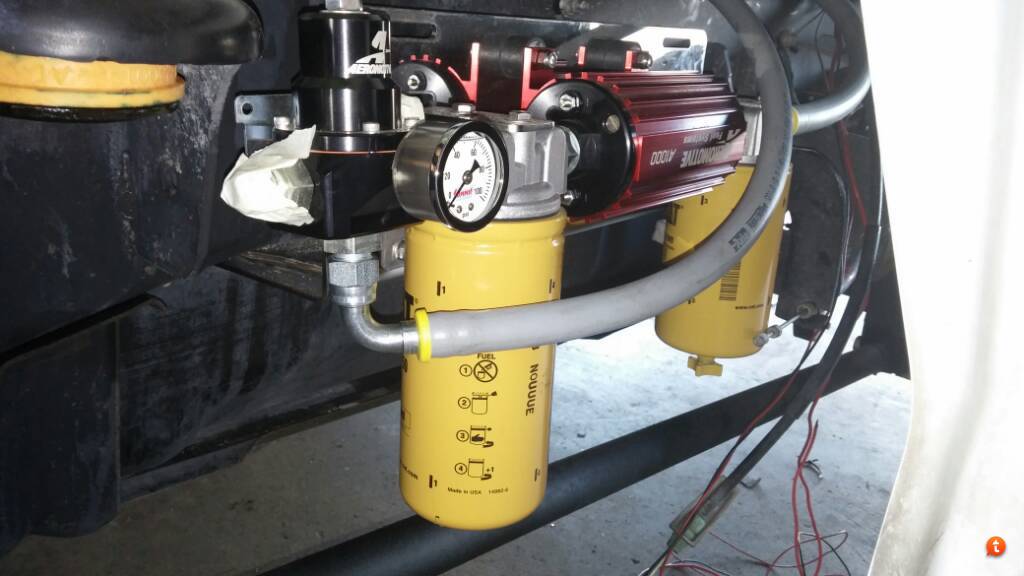

Forgot to post these from the other day. Hell wig sway bar on front along with the fuel system mounted and in tank mods complete.

I really like how you did the fuel system by the tank. That is super clean and should help since you aren't running a sump.
Thanks it worked out well there plus that was really the only place it would fit due to my traction bars. Plus that part of the frame is higher and can't see it at all hanging down looking at the truck with the bed back on.

Fuel system came out awesome. I really like that idea of mounting it back near the tank. Now you got me thinking hahah

That's what I referring to....I don't mind, but you can see mine hanging down from a distance....not bad and I am still happy with it, but yours will be a really clean setup.

Thanks lol always something u want to change thats why its taking me so long to get this thing done keep reading and getting ideas on here and there comes another mod or change to current one.

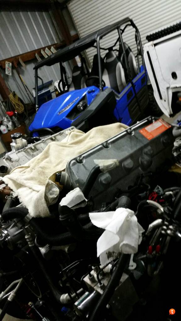

Well got Mikes studs in and the all valve train complete and injecters with 30 percent nozzles etc done and also got Morgan's 3x intake manifold on. So heads and Intake Complete. The 3x looks great. Putting the updated hpfp cover and gasket on when they show up next week. Then the turbos go on and finish Marty's fuel system getting close to the cab going back on. Oh wait Morgan's dual fuelers should be headed my way by end of next week can't wait to drive it

This is such a sick build! Glad to see you cutting no corners! I'm super anxious to hear your first impressions brother!
Thanks can't wait for it to be done. Figured while the cab is off is the time to get it all done. So ready to crank it the 1st time.
