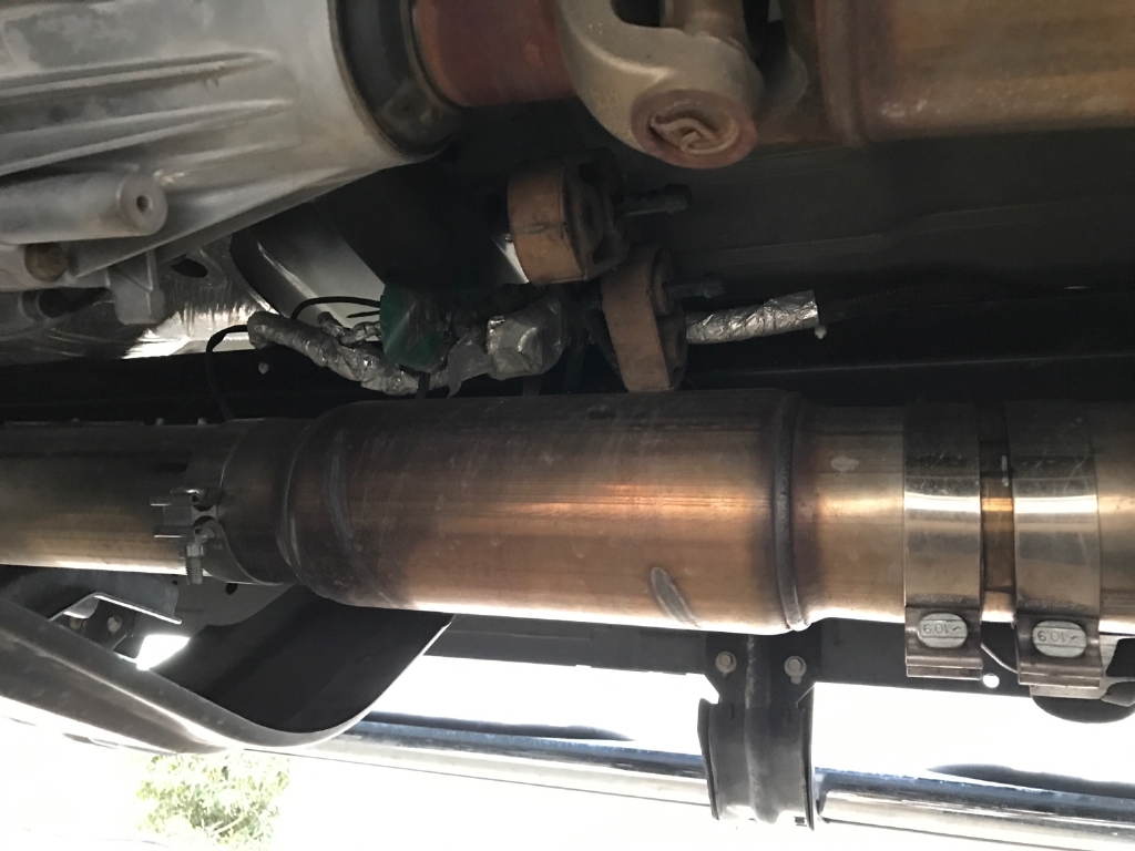

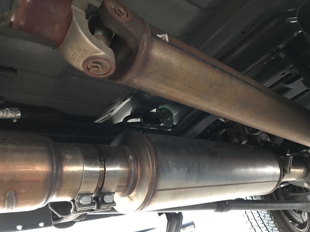

17in resonator, Magnaflow muffler, the vein opening/closing is almost gone in terms of sound. WOT is super quiet, I love it. I have a video of before and after and can't seem to upload it right now. I'll try to upload it later.

Thanks for those pics!!!
Btw... I totally dig your virtually rust free undercarriage! Looks great!

Thanks, Truck is filthy in that pic lol. I'm the guy with the pressure washer on a creeper every time I wash the truck.
Got to love AZ though. I'd hate to see rust.
