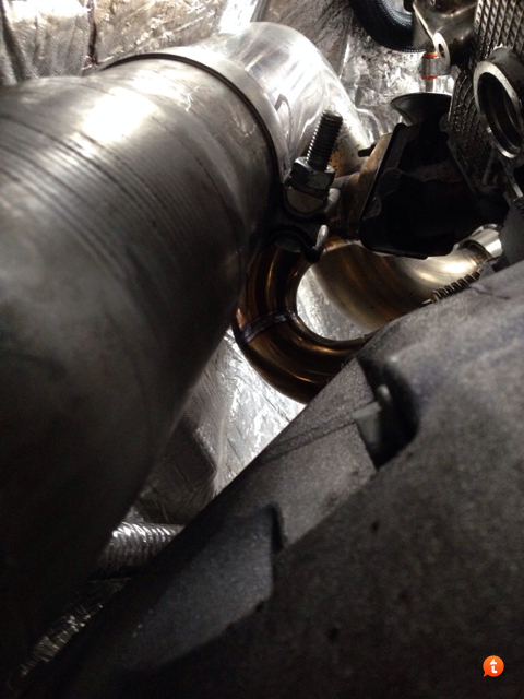

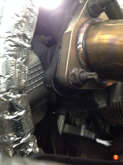

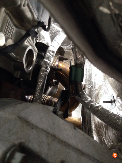

More pics after the install looking for leaks after 100 miles.
Just wanted to show how well everything fits
