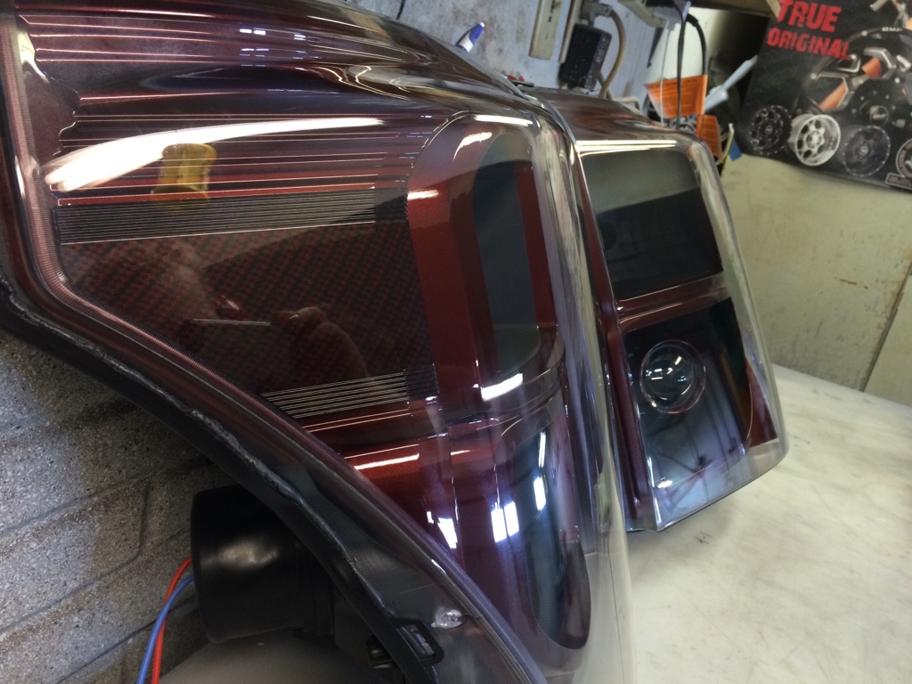

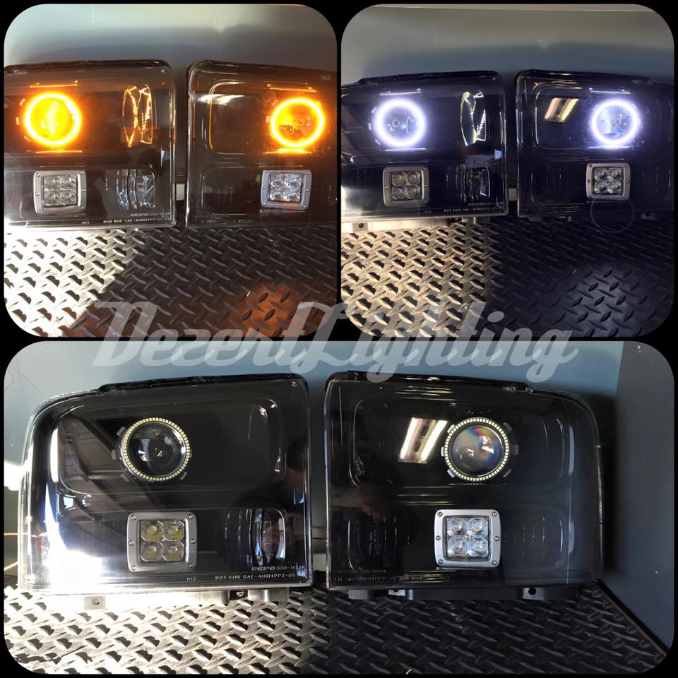

we build and retrofit headlights , i cant put into detail and pictures of how nice a quality build make a truck look and the output of light.
