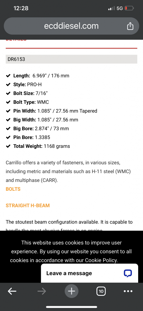

Never said he “ the engine builder “ ever said to use 6.0 rods like I said I’m winging this whole thing gathering up information as I go but according to east coast the 6.7 6.4 and the 6.0 have the same length rods so the difference is in the piston as well as the pin size
Jakes155
Jan 30, 2024
Richmond Va
But after watching the video information from kdd the 6.7 pistons with the Carrillo rods may be the way to go it don’t make any sense to buy the same crap that failed to begin with ! So still undecided
