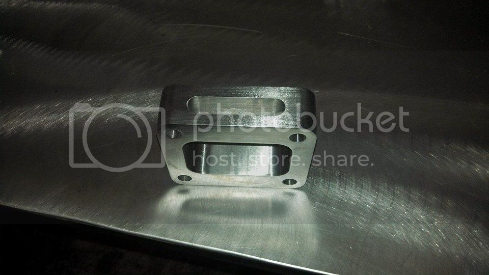

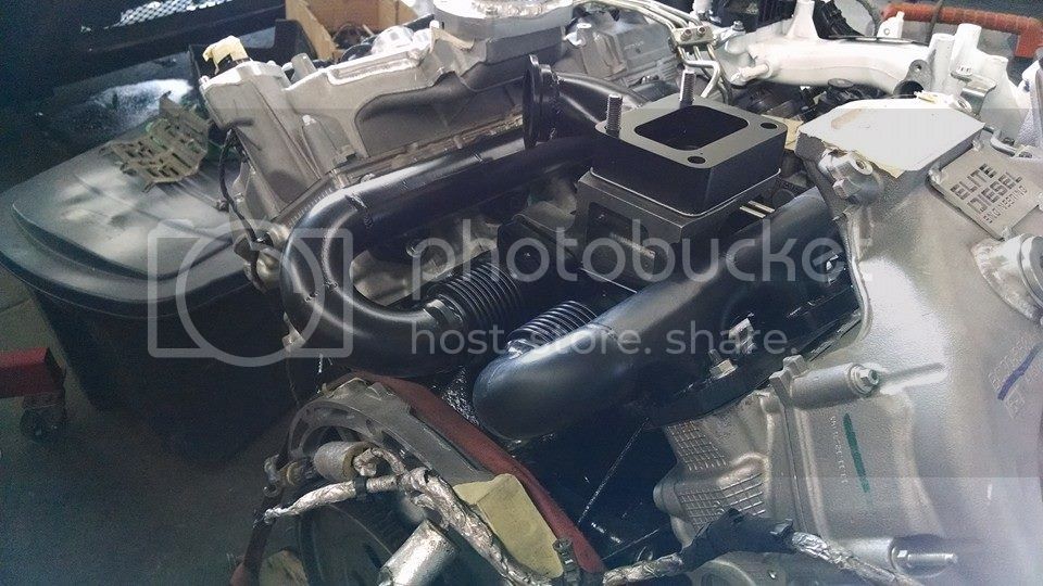

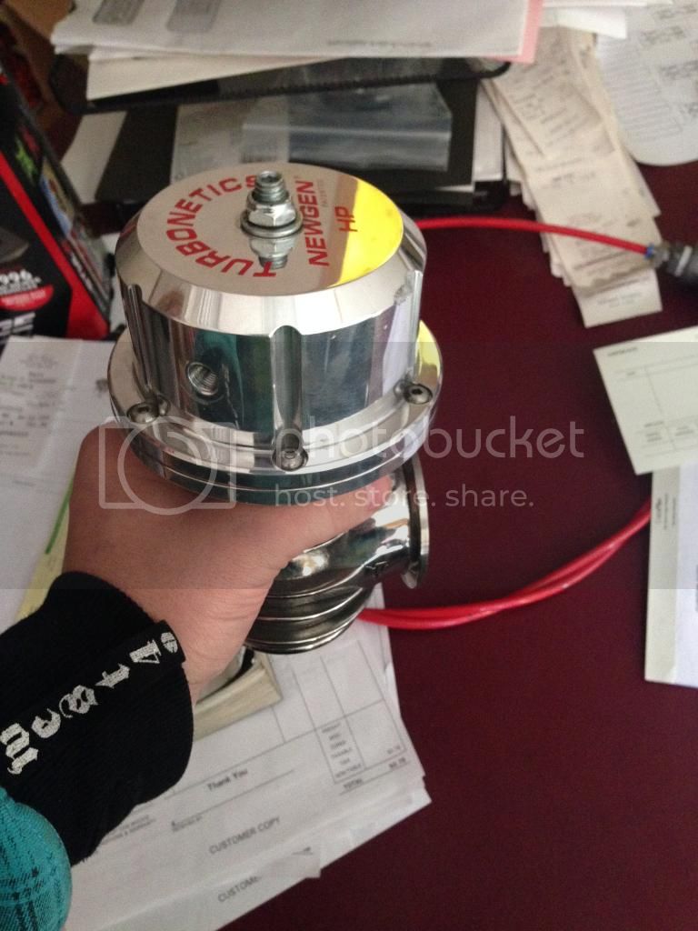

Need some input in my current wastegate setup... Currently I have my wastegate tube coming off this spacer feeding atmo turbo and in my opinion it's not very optimal in the flow department and might be causing me some high exhaust pressures... Now going forward, would you use the gate coming off this spacer as a dump gate, and go dual gates into the 55, one off each manifold? Or would one gate off one manifold be sufficent to feed the 55? If you are following what I'm saying here... I don't know if I like the idea of having a gate off one manifold might cause inballanced pressures between banks? Any advice is welcomed! Thanks!

Newgen hp is the current gate,
And if was thinking pulling exhaust off each of the mpd manifolds right at the elbow and feeding two gates then into the hot pipe... If that makes sense?

I would run either a huge gate, or two. My first gate coming off my pedestal is maxed out with my boost, so yours will need to be able to move quite a bit of air. I would just run one off each manifold if I were you.
