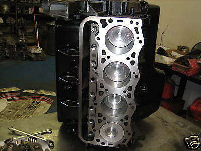

For starters the early block does not have the Webs across the lifter valley. Think it was like in late 96 when they made the changes?
1005dp_01%2Bdiesel_power%2B2002_ford_f250_power_stroke_diesel_rebuild%2Blong_block.jpg
