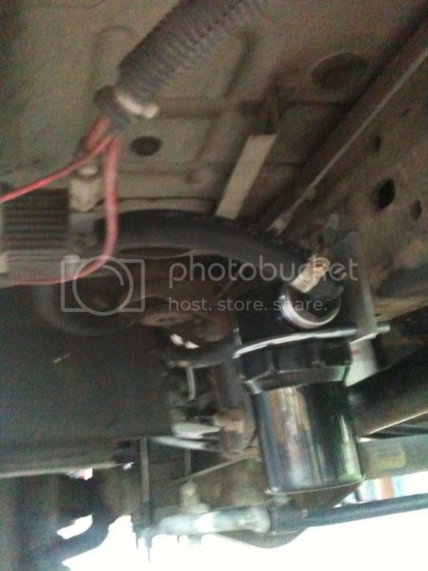

got a P/N? do you mount it on the passanger side over the trans back into the intake.
Driver's side, and then back into the intake.

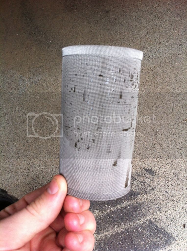

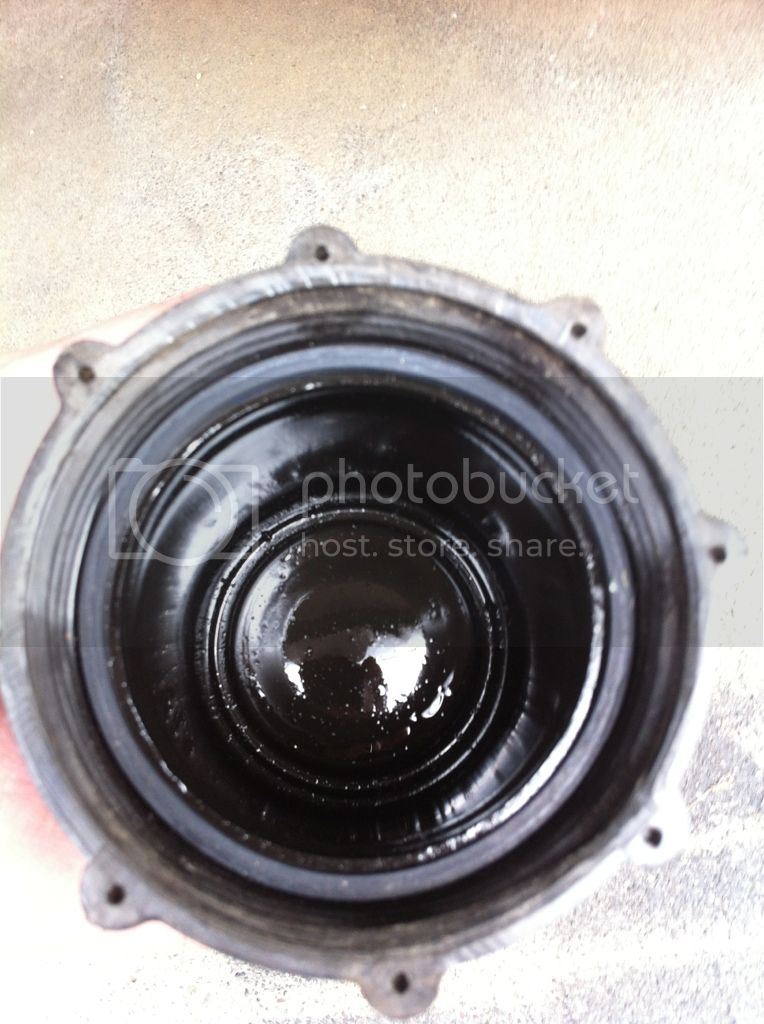

How much oil are you getting in there?
This was after a couple thousand miles. Just a slight film on the screen and the bottom of the can. This will change depending on how much blow-by you have as well.
