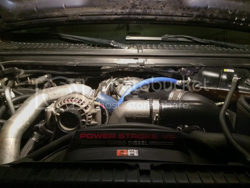

Finished tonight and fired her up. Had a bad ICP sensor but starts and runs fine when unplugged. Also got a TBC fault which is annoying lol. Have an air in fuel problem as well - see new thread here. Any help appreciated guys.
http://powerstrokearmy.com/forums/showthread.php?t=50100
Finished product
mine has a TBC fault too. I think it is because one of the plugs on the bottom of my brake master cylinder is messed up and therefore unplugged. Check the plugs and make sure they are in there good. I have been told this will cause this issue.

I talked to someone today who said they get that fault every time they have performed work on different trucks which requires extended crank time?? Maybe just another weird 6.0 quirk??

yeah it seems to be hard to diag. Mine has done it since the last time the cab was up over a year ago. It drives me nuts but no one can give me an answer. My buddy said one of the plugs on his master cylinder was unplugged, he plugged it in and the fault went away. Did you double check yours?

even if the plugs go in all the way, check the the prongs on the plugs with a mirror, sometimes they can get bent and not connect.
